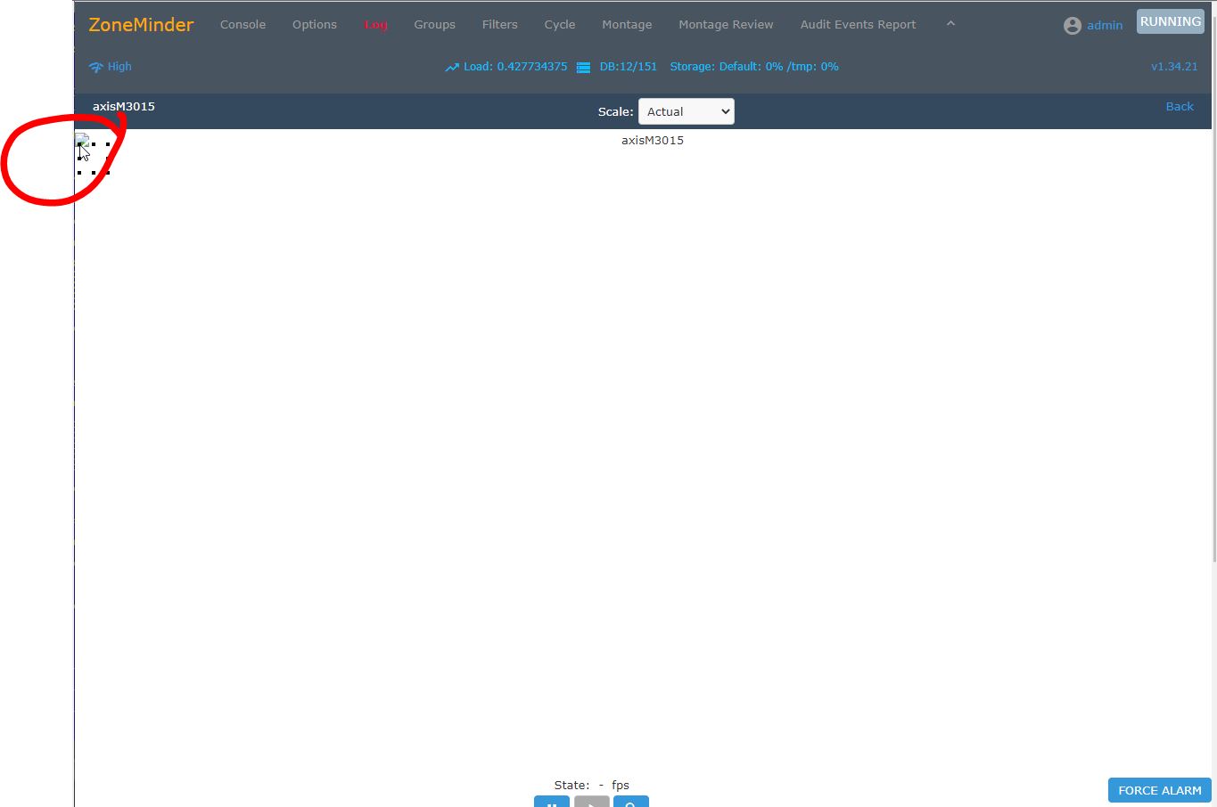

I can modect and record when events happen but both the "Name" link does not show a preview of the camera live and neither does it show any video when I define zones.

well having all lowercase and 2 numbers with 8 characters in total does not work
anonymous with no password does not work
I can still get the zone to pick up and record when there is motion and I just reviewed that it still works. Here is the errors in my log:

2021-03-11 17:48:54 web_php 4197 ERR Socket /var/run/zm/zms-879467s.sock does not exist. This file is created by zms, and since it does not exist, either zms did not run, or zms exited early. Please check your zms logs and ensure that CGI is enabled in apache and check that the PATH_ZMS is set correctly. Make sure that ZM is actually recording. If you are trying to view a live stream and the capture process (zmc) is not running then zms will exit. Please go to http://zoneminder.readthedocs.io/en/latest/faq.html#why-can-t-i-see-streamed-images-when-i-can-see-stills-in-the-zone-window-etc for more information. includes/functions.php 2188
2021-03-11 17:48:52 web_php 4197 ERR Socket /var/run/zm/zms-879467s.sock does not exist. This file is created by zms, and since it does not exist, either zms did not run, or zms exited early. Please check your zms logs and ensure that CGI is enabled in apache and check that the PATH_ZMS is set correctly. Make sure that ZM is actually recording. If you are trying to view a live stream and the capture process (zmc) is not running then zms will exit. Please go to http://zoneminder.readthedocs.io/en/latest/faq.html#why-can-t-i-see-streamed-images-when-i-can-see-stills-in-the-zone-window-etc for more information. includes/functions.php 2188
2021-03-11 17:48:52 web_js 4196 ERR getStreamCmdResponse stream error: Socket /var/run/zm/zms-879467s.sock does not exist. This file is created by zms, and since it does not exist, either zms did not run, or zms exited early. Please check your zms logs and ensure that CGI is enabled in apache and check that the PATH_ZMS is set correctly. Make sure that ZM is actually recording. If you are trying to view a live stream and the capture process (zmc) is not running then zms will exit. Please go to http://zoneminder.readthedocs.io/en/latest/faq.html#why-can-t-i-see-streamed-images-when-i-can-see-stills-in-the-zone-window-etc for more information. - checkStreamForErrors() ?view=zone
2021-03-11 17:48:52 zms_m1 101537 ERR Unable to authenticate user zms.cpp 207
2021-03-11 17:48:51 web_php 4196 ERR Socket /var/run/zm/zms-251270s.sock does not exist. This file is created by zms, and since it does not exist, either zms did not run, or zms exited early. Please check your zms logs and ensure that CGI is enabled in apache and check that the PATH_ZMS is set correctly. Make sure that ZM is actually recording. If you are trying to view a live stream and the capture process (zmc) is not running then zms will exit. Please go to http://zoneminder.readthedocs.io/en/latest/faq.html#why-can-t-i-see-streamed-images-when-i-can-see-stills-in-the-zone-window-etc for more information. includes/functions.php 2188
2021-03-11 17:48:50 zms_m1 100774 ERR Unable to authenticate user zms.cpp 207
2021-03-11 17:48:50 zms_m1 102155 ERR Unable to authenticate user zms.cpp 207
2021-03-11 17:48:49 zmc_m1 101519 INF axisM3015: images:2400 - Capturing at 10.00 fps, capturing bandwidth 45140bytes/sec zm_monitor.cpp 2534
2021-03-11 17:48:45 zms_m1 101537 ERR Unable to authenticate user zms.cpp 207
2021-03-11 17:48:41 zma_m1 102068 INF axisM3015: 1200 - Analysing at 5.26 fps zm_monitor.cpp 1303
2021-03-11 17:48:39 zmc_m1 101519 INF axisM3015: images:2300 - Capturing at 10.00 fps, capturing bandwidth 44689bytes/sec zm_monitor.cpp 2534
2021-03-11 17:48:31 web_php 4197 ERR ZoneMinder is not configured properly: php's date.timezone -0500 does not match the system timezone -0800! Please check Options->System->Timezone. includes/functions.php 2423
2021-03-11 17:48:29 zmc_m1 101519 INF axisM3015: images:2200 - Capturing at 10.00 fps, capturing bandwidth 43303bytes/sec
