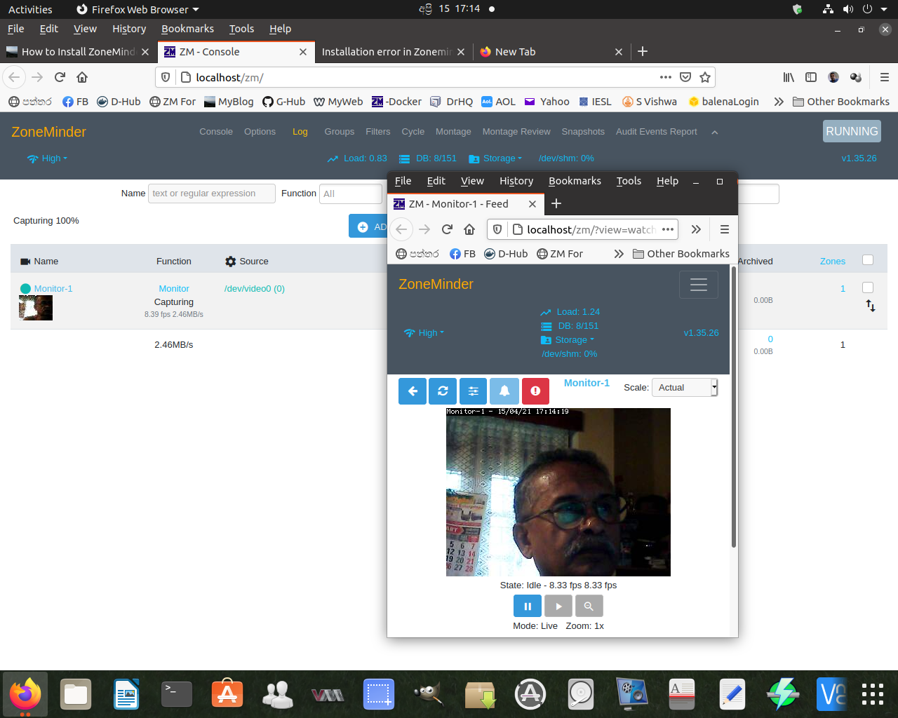

Installation problem solved , after using your fix ( fix at the following link ) on the /usr/share/zoneminder/db/zm_create.sql ,
https://github.com/ZoneMinder/zoneminde ... e6c99192d0
Screenshot from 2021-04-15 17-14-19.png (390.55 KiB) Viewed 4766 times
zm_create.txt
(224.92 KiB) Downloaded 187 times

sudo su
add-apt-repository ppa:iconnor/zoneminder-master
apt update
apt -y install zoneminder
( Now you will see some error message ie Error: Process completed with exit code 100. )
Then go to the following Issac Connor's web link
You can see the corrected lines within the green color block .
Open the file at /usr/share/zoneminder/db/zm_create.sql
sudo gedit /usr/share/zoneminder/db/zm_create.sql
Delete the 793 line of the opened file zm_create.sql .
Then copy Issac Connor's fix at above link marked in green color block and paste at line 793 and save.
Then configure zoneminder and apache as usual.
Please refer the following link for get more details
https://bkjaya.wordpress.com/2020/11/16 ... cal-fossa/
