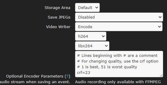

pixelation? What storage method are you using? Encoding with setting some options like crf can cause this

I had some errors before using ffmpeg for years , you suggested the settings in the pic below which worked
- Screenshot_12.jpg (66.09 KiB) Viewed 1458 times
