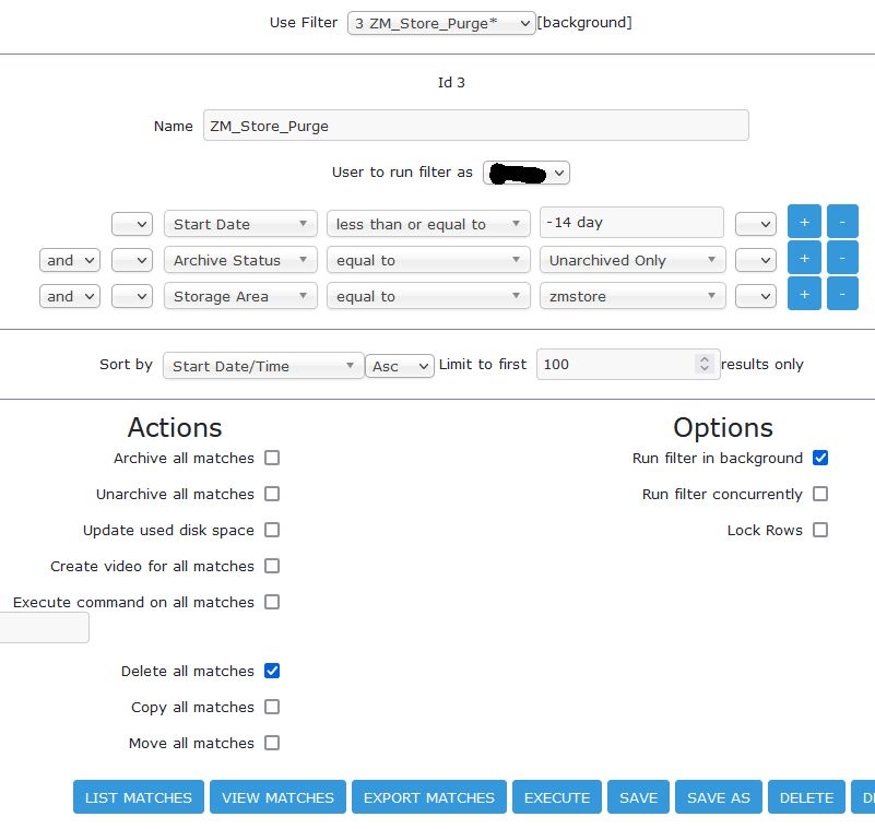

OK, as a test create and run this. Set the -7 day out one day less than your oldest events so you only delete one day of events. Make sure it runs as a privileged user (admin). Let it run in the background and it may have to run overnight. You need to use the default storage area.
If this works there is something wrong with the way you create the filter.
AS suggested you may have to run zmaudit.pl to check and fix the zm database.

I set a "test filter" as you asked. I tried to execute it and it deleted nothing. I will let it run overnight to see but doubt it will make difference

apti wrote: Wed Aug 18, 2021 12:20 am I set a "test filter" as you asked. I tried to execute it and it deleted nothing. I will let it run overnight to see but doubt it will make difference
By any chance do you have OPT_FAST_DELETE enabled? If you do please disable it.
The filter did nothing over night. I also do not ever enable the fast delete option and checked to be sure it was not on and it is not. I did note a difference in the 2 sites I am dealing with. The one with the filter issue is on 1.36.5 and the one working is on 1.37.0 I originally thought they were both 1.36.5. Is the issue as easy as upgrading the other to 1.37.0? Something I must wait to do until I can go onsite.

the filters are still not working. upgrade to 1.37 is not possible as 1.36.5 is latest available in fedora repo. So we are set on fixing this issue in this version unless another is released. Also I had to post a serious problem in version 1.37.
