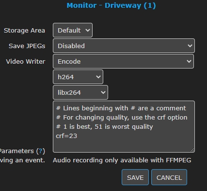

This is the only error I have in my log, I have exhausted all ideas and searches to fix this. any clues ?
Encoder Option # Lines beginning with # are a comment # For changing quality, use the crf option# 1 is best, 51 is worst quality crf not recognized by ffmpeg codec
Encoder Option Error

Re: Encoder Option Error
Try removing the commented lines.
There seem to be have been changes in FFMpeg/libx264 recently(?) and it looks like FFM is reporting the whole block including the '# comments'' as a parameter. Many of the option name=value pairs have changed too.
Thank You
removing
and leaving fixed it
crf=23
And it also fixed the 3 sec pixilation during event playback
