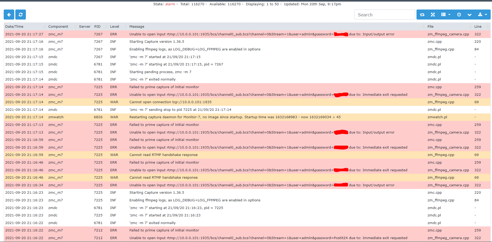

I have installed zoneminder on my new RPi4 following the debian instructions.
I can capture from my Reolink 411 camera using rtsp but it suffers from almost continuous tearing so I am trying to get RTMP to work.
Just changing the capture to RTMP will not capture any images at all. I get the following log entries repeatedly:
I have tried to activate logging but even though it says in the log that FFMPEG logs are enabled I can't find them anywhere :( . I have followed the instructions to activate logging here https://zmeventnotification.readthedocs ... ml#logging

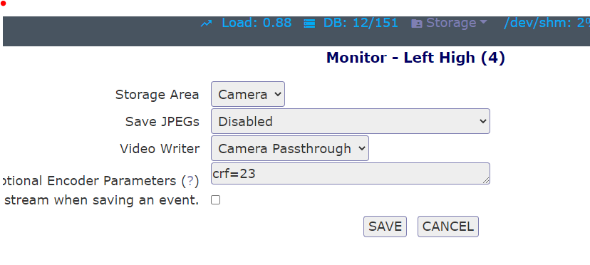

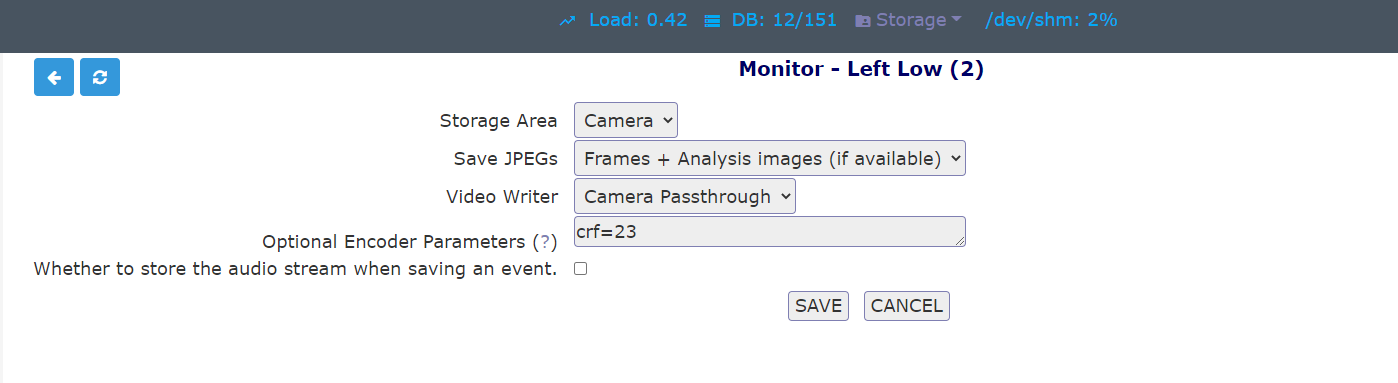

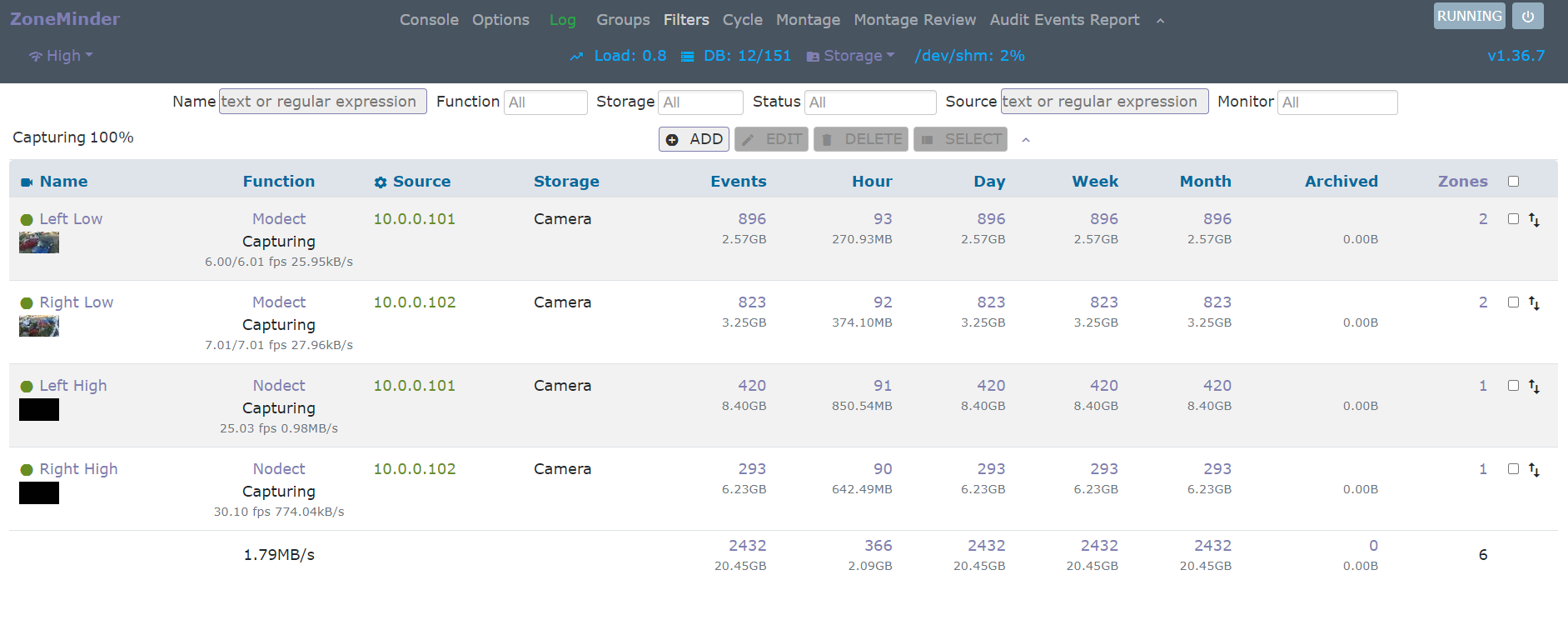

Raspberry Pi4 8GB, Ubuntu 20.04 64 bit, boot from SD card and writing video to 1GB USB HDD.
I have two cameras(reolink 410 and 411)
Two sources defined, set to Modect on the low-res 640/356 rtmp streams. Storing video and stills.
Then two more sources defined set to Nodect on the high-res 2550x1440 rtmp streams with no decoding and just storing video on a passthrough.
