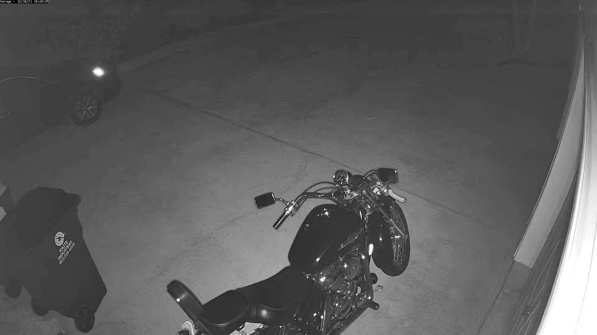

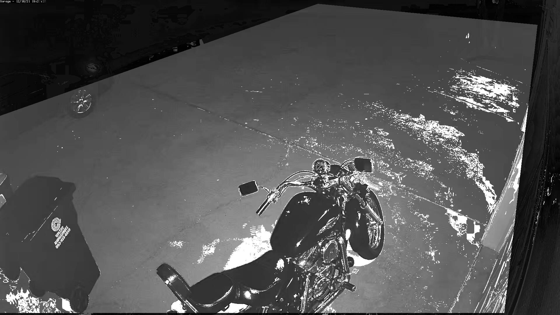

I'm having problems with false positives in motion detection every so often and when I look in the frames to see what triggered it I see something that appears to be edge detection, with a rectangle overlayed that matches the motion detection zone I've set. Clearly it's somehow screwing up the motion detection process and bleeding through some of the processing images which of course makes that frame way different from the before and after frame which causes it to alarm. Does this day and night.
Sometimes it's up to 8 frames in a row that look like this:
This frame is usually just sandwiched between perfectly good frames that look like this one:

Maybe it is analysis frames but it doesn't show on most frames that do detect valid motion. Maybe I just am getting regular false positives and for some reason it's showing that.
More testing supports that and gives me the same results someone else has reported on the forums - but I don't know how to turn analysis frames on or off so this was quite surprising:
It seems that the analysis frames are not shown on video playback but require clicking on "frames" or "alarm frames" in the event view. Then, clicking on one of the alarm frame numbers (in red) will show the outline of the Blob identified. Selecting any other frame and stepping forward to alarm frames will not show the blob outline.
