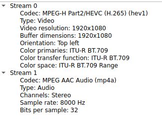

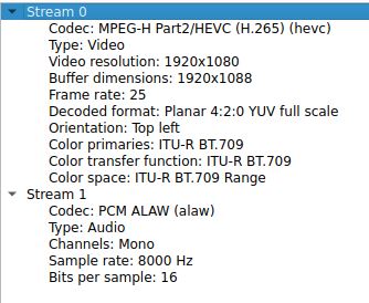

Ah interesting, looks like maybe the passthrough is losing important codec information.
Note:
* Different codec tag (hevc vs hev1)
* The lack of frame-rate
* Changed buffer dimensions
* Lack of decoded format lines
In the file created by ZoneMinder passthrough (though perhaps all or some of that is due to the file being unplayable?).
