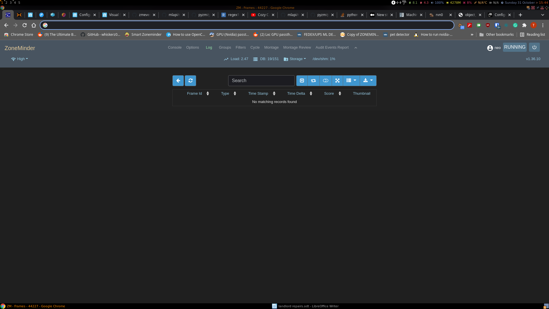

The nodect monitor has the RED status indicator and the analysis fps are at 0.00. The monitor creates events that are viewable but it does not write any of the Frames data to the DB. This causes an error when ZMES tries to query the ZM API for the event data and receives an empty 'Frames" structure.

The no frames view ->
Frames DB - Alarm Frames
NO frames.png (98.71 KiB) Viewed 1144 times
