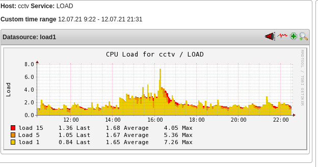

Cameras are recorded in mp4 through and look in the browser in edit(montage) mode. Video analysis is disabled.
When the stream was 1fps, the load on the server was insignificant and everything was fine. After increasing the frame rate to 8, the load on the server increased significantly and the montage mode practically stopped working.
How to optimize the load on the server or it can only be corrected by hardware increase of the server itself?

How many cameras, what resolution/bitrate/profile level? Are you doing pass-through or transcoding in Zoneminder?sergmx wrote: ↑Tue Jul 13, 2021 4:05 am I use the version 1.36.4
Montage mode takes the incoming stream from the buffer (assuming, since it makes the most sense), converts it into the format specified in the ZM config and sends it to your browser. So if you're using MJPEG for live streaming, for example 10 cameras @ 8 FPS that means 80 H.264/.265 frames being decoded/transcoded into MJPEG format per second. Going from 1 to 8 frames doesn't seem like a lot, but it means a drastic increase in CPU load for that workload. Keep in mind with that many cameras, you're might be pushing 100mbit/s+ to view that depending on your settings. As an alternative, try using Montage Review, which by default sends 1 frame per second per camera to the browser. Or by grouping your cameras so you're viewing 2/4 cameras at once instead of 10/20/x. Alternatively, reduce the quality of your montage stream. (see Option-Images or trying to introduce different transcode settings if you're pushing something other than MJPEG to the browser.)
Or try attacking the issue from the opposite direction, reducing bitrate/profile level on your cameras to make decoding easier. If your cameras are sending video with a 24bit color space, try setting the ZM camera settings to use 24 bit colors instead of 32 bit. I'd investigate if this reduces load, since it's possible the code for your platform is more optimized for handling 32bit pixels than 24.
You need to factor in your HTTP server now handling more requests per seconds to push those extra frames to your web clients. Every 100 frames is written as a bulk frame entry into the DB, maybe increase that value in the options as well if you see DB CPU usage spiking.
I'd make a wild guess that 1# user of CPU time is ZMC processes, followed by httpd/nginx/etc, followed by MySQL/MariaDB/etc.
It's possible Montage mode is choking because of CPU contention, network bandwidth, or because all the web server workers are busy with requests and can't keep up. Try to figure out where the bottlenecks might be.

I did that, it didn't seem to help much. To make it work, I have now lowered the frequency from 8 to 2. It seems to work ...

12 AXIS (different) camers
resolution from 640 x 480 to 1600 x 1200 (maximum for each camers)
Except 2 cameras firmware version 5 and I shoot the stream : rtsp://user:xxxx@192.168.xx.xx:554/axis-media/media.amp?videocodec=h264&streamprofile=Quality
By setting the right fps in the camera profile themselves.
pass-through - I think it will be less load on the server in recording mode.
Hardware: AMD Athlon(tm) II X2 270 Processor, Mem: 6G
Thank you very much for the advice I will try and figure it out, but I think the main load when decoding video when the client in the browser.
(The client is another computer)
Here is a picture of when I first set it to 1 frame per second when recording a stream.
(event - hour - day : from ALL camers)
