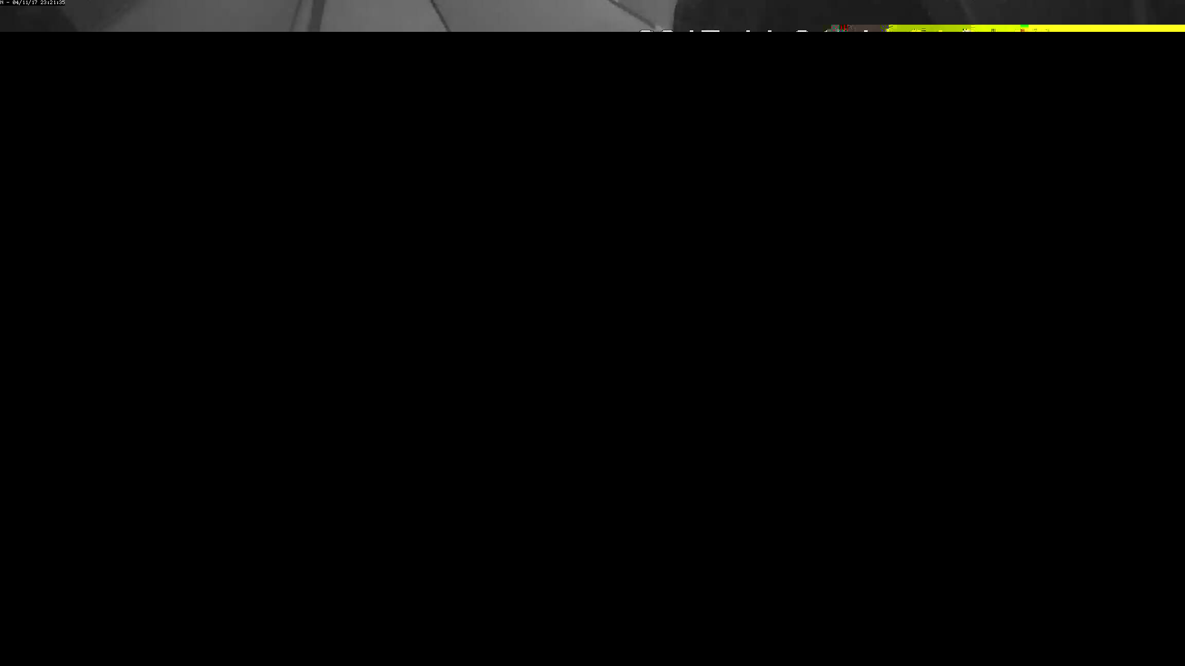

I've installed ZM 1.30.4 on my FreeNAS box. It works great except that when it sends email notifications the attached images are corrupted. It only shows a small portion of the image and the rest is gray. I'm using SSMTP. I've confirmed SSMTP works fine and have used a command similar to the following to attach an image from ZM:
echo -e "to: receiver@domain.tld\nsubject: subject\n"| (cat - && uuencode /path/to/attachment attachment.name) | ssmtp sender@gmail.com
An example image is attached.
I'm guessing this is an issue somewhere in ZM or in Perl?
- 00026-capture.jpg (112.62 KiB) Viewed 54954 times

Note that the source files that ZM tries to attach, like zoneminder/events/1/17/11/04/21/11/56/00026-capture.jpg, is perfectly fine and I'm able to attach it to an email with SSMTP when directly calling SSMTP on the command line. But when ZM tries to do the attaching, the problem above happens...
