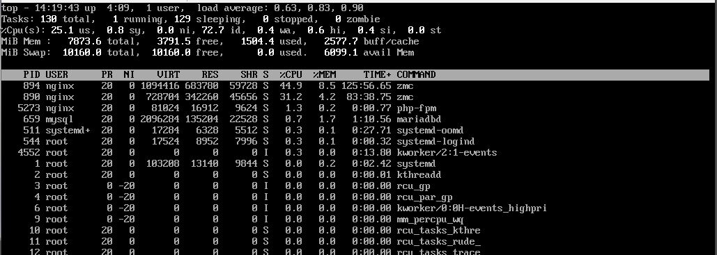

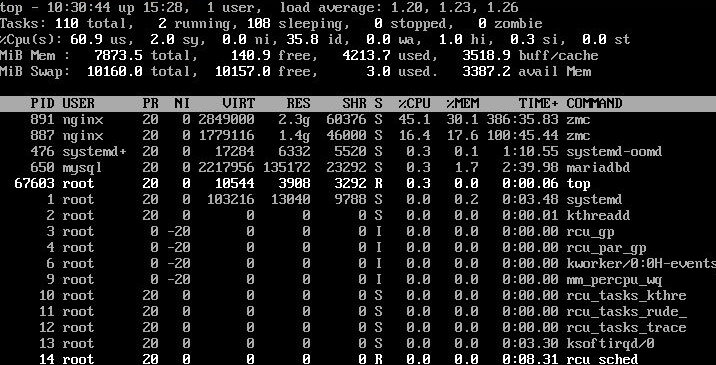

Not solved. ZM keeps getting killed. It looks like ZM is hanging onto too much memory. If there's anything else I can post here that can be of help, let me know. Here's a "top" of the system after running for a while:

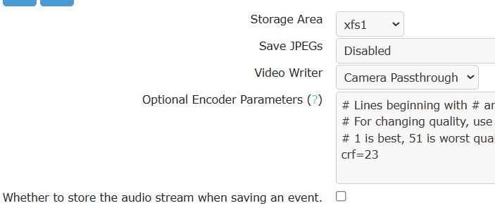

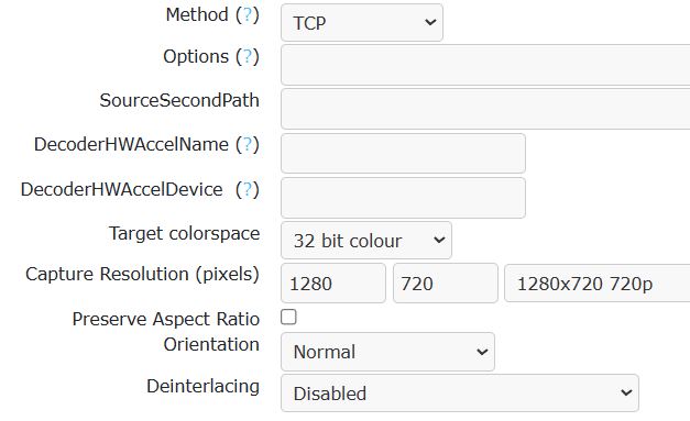

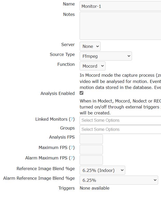

Just to add some more information, here are the settings for one of the cameras. There appears to be a limit, so will add more settings in another post.

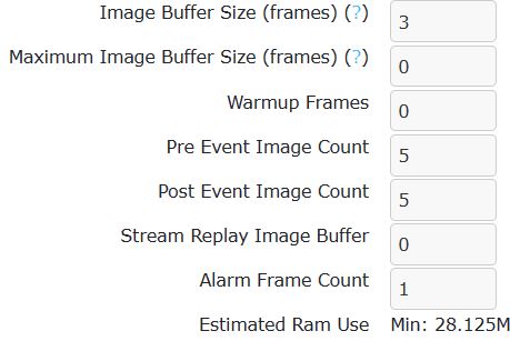

Settings for buffers:

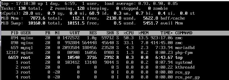

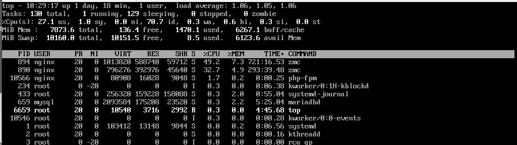

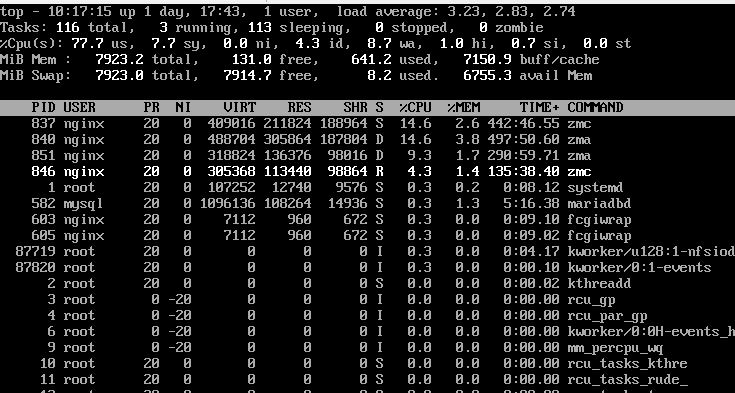

Magic919 wrote: Thu Jan 06, 2022 9:19 am Try disable saving JPEGs if you haven't already.
ZM got killed by OOM after 3 days (?) after disabling JPEGs. I will note that I was running with OOMD off (see oomd.conf in my first post).
Here are some "top"s over time. I only got 2 days worth. ZM was killed about 12 hours after the last image.
Day 1:
Day 2:

Turning off Save JPGs does disable live view, which is a dealbreaker. I don't know what to do at this point, perhaps I'll try a different distribution perhaps CentOS or Ubuntu. Or perhaps install an older version of ZoneMinder (1.34).

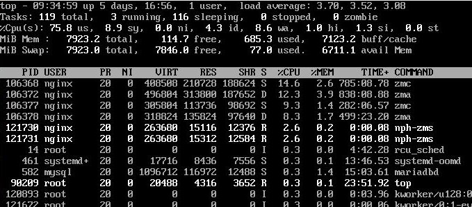

I installed an older version of ZM (1.34.26-1) on Fedora 34. This was installed without on disk swap, so with only compressed swap in RAM.
This older version of ZM was unavailable on Fedora 35, otherwise I would have gone with the newer Fedora.
The memory usage has been low and stable over time - memory usage does not grow. I also noticed that on this version of ZM, when something moves on camera, the live views stay responsive. The newer version live views would freeze for 20 or more seconds. So for now this is what I will go with.
Here is a "top" after a few days:
chue
