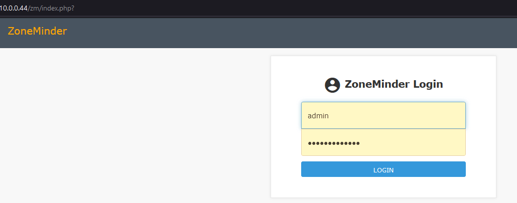

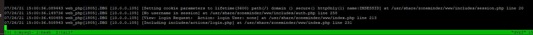

So I enabled additional logging... and it seems to be the login page isn't sending back to the server the username and password.
I attach the screenshots of what I see.
In the browser, when I am going to login as admin, and put in the password, I hit enter.
The logs show "User: none".
Could this be the issue?
RELEVANT LOGS BELOW
07/26/21 15:00:36.089443 web_php[1805].DBG [10.0.0.105] [Setting cookie parameters to lifetime(3600) path(/) domain () secure() httpOnly(1) name:ZMSESSID] at /usr/share/zoneminder/www/includes/session.php line 20
07/26/21 15:00:36.149736 web_php[1805].DBG [10.0.0.105] [No username in session] at /usr/share/zoneminder/www/includes/auth.php line 258
07/26/21 15:00:36.400485 web_php[1805].DBG [10.0.0.105] [View: login Request: Action: login User: none] at /usr/share/zoneminder/www/index.php line 213
07/26/21 15:00:36.508943 web_php[1805].DBG [10.0.0.105] [Including includes/actions/login.php] at /usr/share/zoneminder/www/index.php line 231
