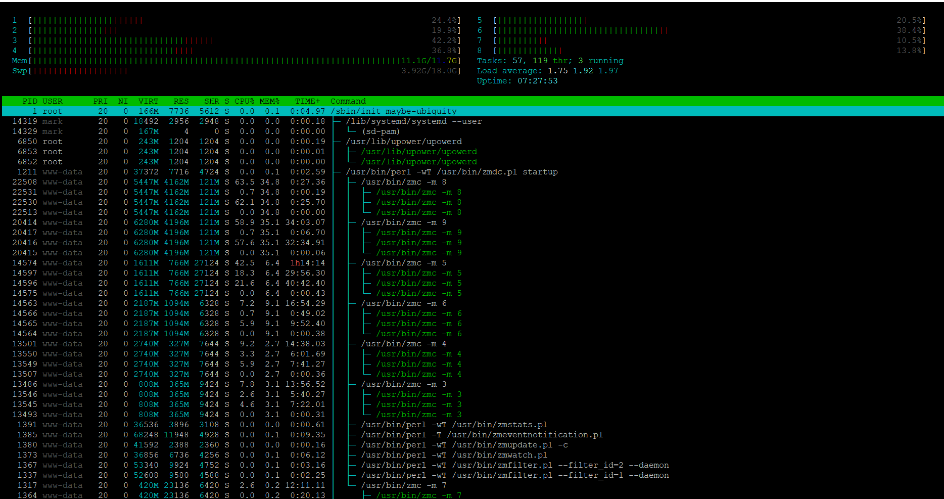

I just experienced this issue under v1.36.12 today. Figured, I would post that disabling saving jpegs seems to be the solution.
There were a lot of motion events and the CPU could not keep up, load was ~21 on an 8 core CPU. Once everyone left CPU load went back to ~2, but memory on 2 processes stayed around 4GB+ each many hours later:

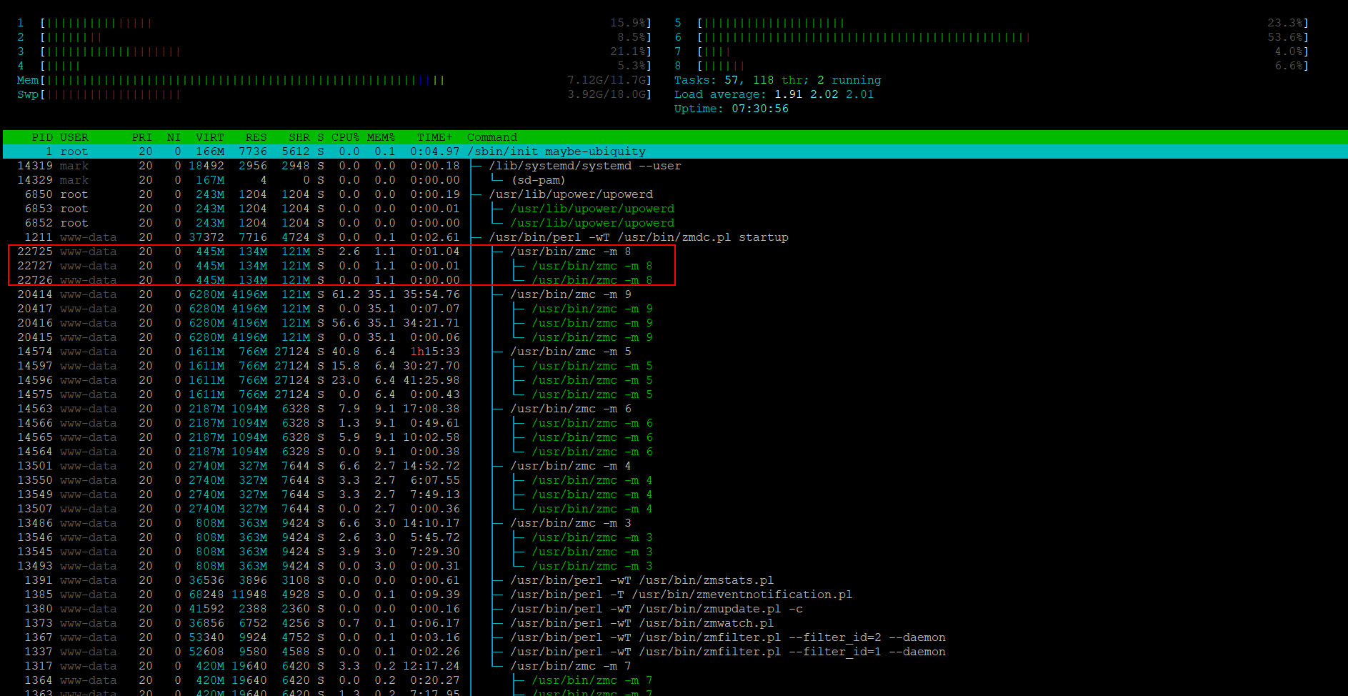

As suggested above, I tried changing monitor 8 from Nodect -> Mocord -> Nodect, but it did not reduce memory usage. Then I disabled saving jpegs and memory dropped from 5447M to 445M! (also, you can see that there is 1 less process running):
Any idea, why saving analysis & jpegs causes excessive memory usage when CPU falls behind?
