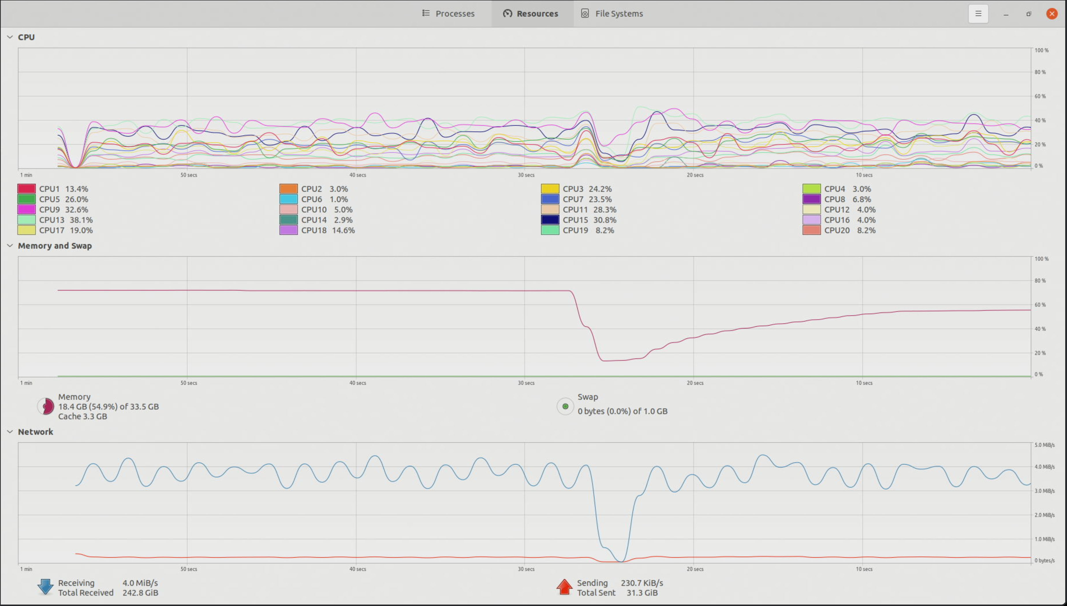

I restarted ZM while looking at the resource monitor.

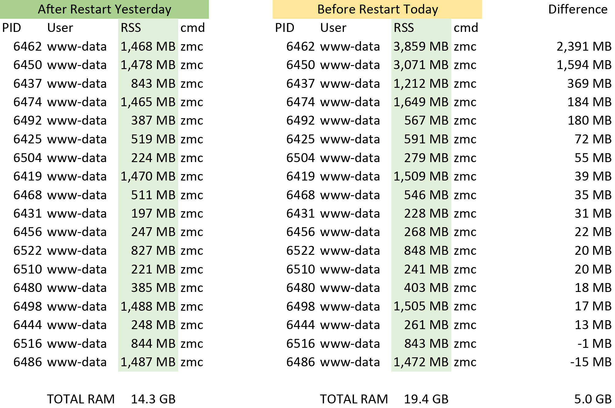

You should be able to see where the restart took place. It was a difference of about 5 GB of RAM freed up after the restart of ZM. I had stored the process information after a restart yesterday and took another look at processes just before that restart and see that all of the changes revolve around the processes "zmc" or as I assume the monitors.
RAM Difference.jpg (367.02 KiB) Viewed 4490 times
I have aligned the processes in order of the differences between the two times. Some of the processes grew by well over a gigabyte and a couple actually got smaller. None of the monitors save JPGs All are set for H.264 passthrough.
