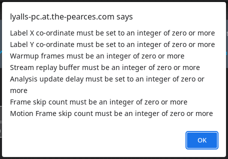

Interesting.
I was not prompted for these previously when setting the camera.
Given they don't have a help '?' link, I guessed their purpose (rather than do the right thing and find the documentation)
However, I have the following settings, which I either changed or was prompted to enter.
Analysis FPS 10
Timestamp Label X 0
Timestamp Label Y 0 (although, these subsequently display as blank and thus will re-prompt for input)
Image Buffer Size (frames) 30
Maximum Image Buffer Size (frames) 90
Pre Event Image Count 30
Post Event Image Count 30
Stream Replay Buffer 90
Frame Skip 0
Motion Frame Skip 0 (although, these subsequently display as blank and thus will re-prompt for input)
FFMPEG_OUTPUT_OPTIONS = -framerate 30 (matching camera options)
I will report back once a few events have recorded.
