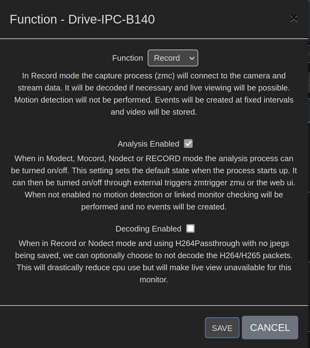

Most HD IP Camera give out H264/5 streams and if you're just recording the main stream you should switch off the decode when doing H264 Pass through
Screenshot at 2022-06-11 17-03-11.png (191.64 KiB) Viewed 11260 times

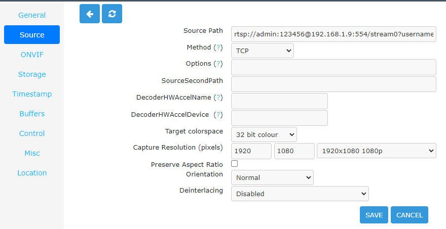

Screenshot at 2022-06-11 17-03-40.png (173.32 KiB) Viewed 11260 times

P.S. Sanitize your images your are showing user/password/ip info

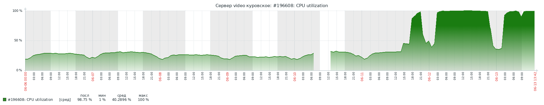

Cramac1
Posts: 111
Re: how to reduce cpu load?
Post by Cramac1 »

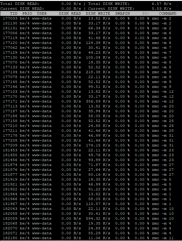

CPU load before installing additional memory and after

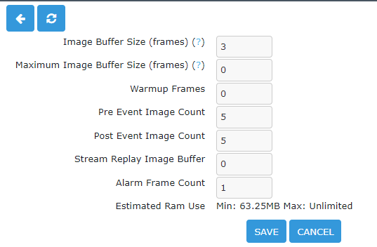

Posts: 1373
What are your buffer settings?

dougmccrary wrote: Mon Jun 13, 2022 8:30 pm What are your buffer settings?
This ^. If you have very large buffers it will eat up alot of cpu cycles. Are you running this on a mechanical HDD or an SSD just switching to an SSD on my server cut the cpu usages in half over a spinner, RAM usage also went down.
What fps and resolution are your cameras this will also play into cpu usage as every frame is decoded and analyzed by zm

ZM is heavy on iotop and is mainly database access with the many writes, it's something that need looking at with future versions of ZM.
You might want to look at mysqltuner to see if that can optimise your database.

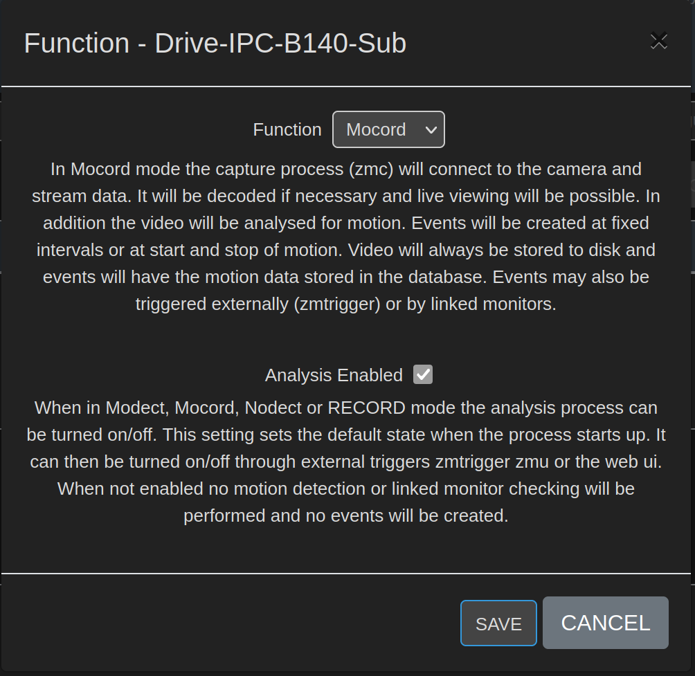

Looking at smt-mir1 you have decode enabled if this monitor is just recording and you don't need to view then turn off decode, I only decode the low resolution feeds that I run the analysis on and use those for viewing.
