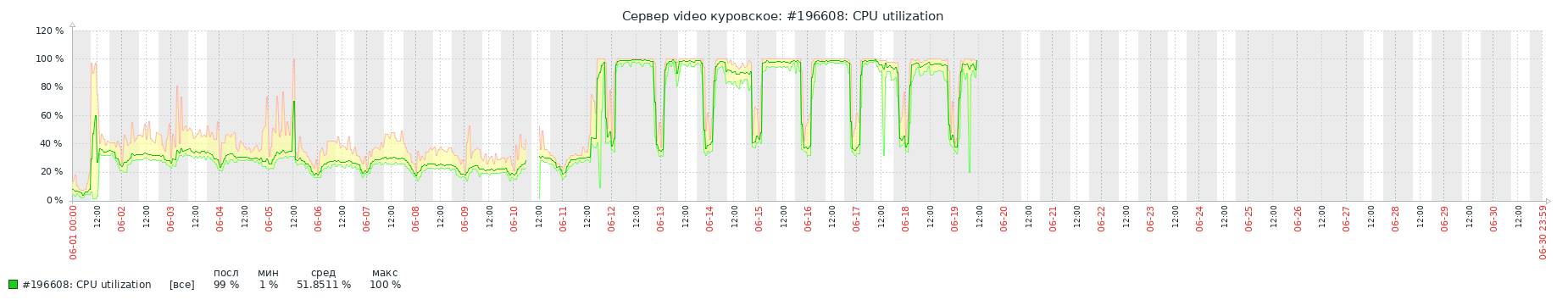

At night, the CPU load drops, then grows again. while the traffic does not drop
chart2 (1).png (97.83 KiB) Viewed 7167 times

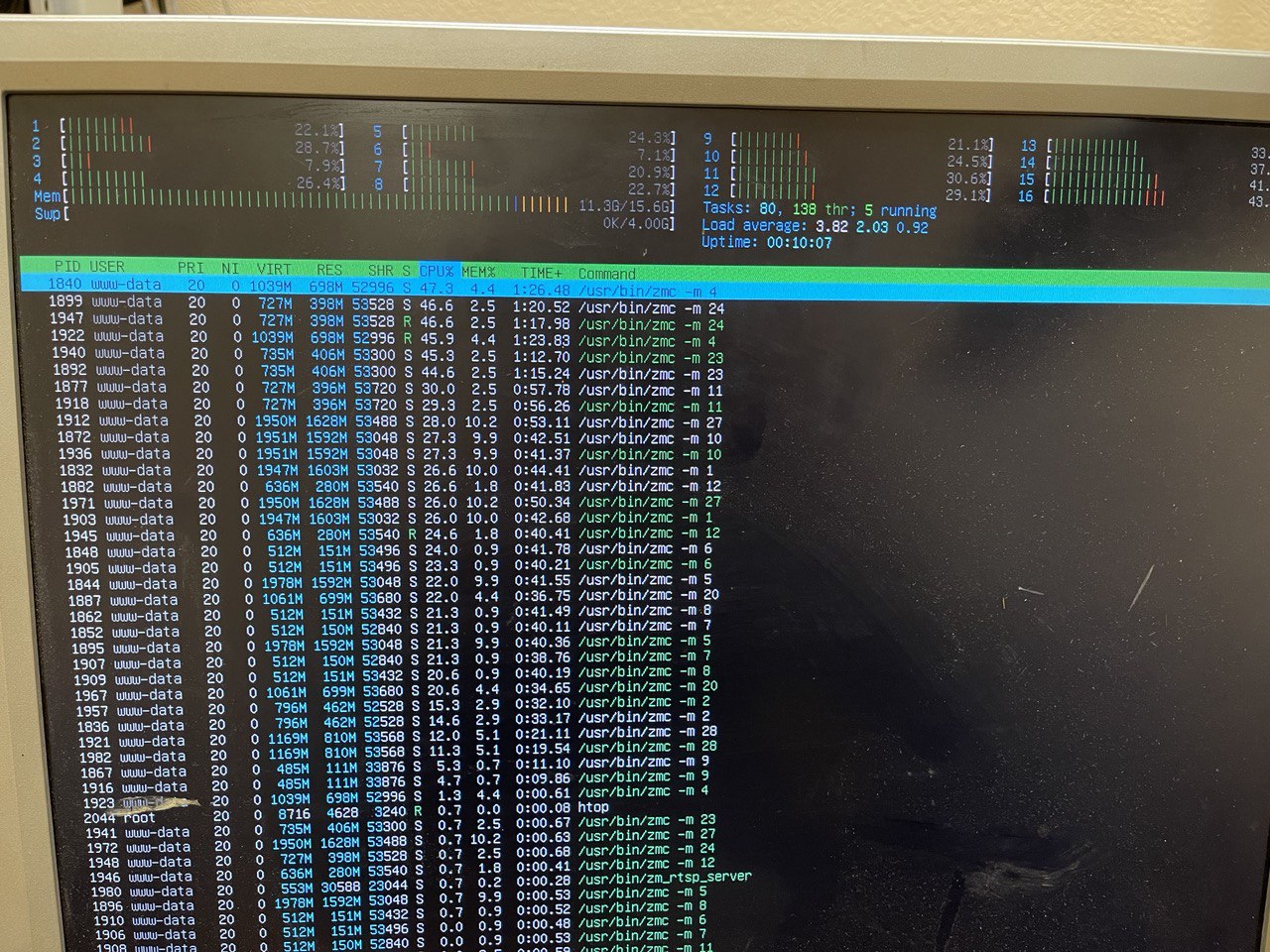

I habve the same problem with 1.36. all 4 Cores are at 100%…with 1.37 ist comes down a bit. I use bullseye. Zm stopped the machine is at 25%, with zm started immedialtely at 100% no matter Cameras are disabled or in Monitor.
That seems high. What's it doing?

Post by kobold81 »
Smbd, Openhab,vzlogger,grafana,postgre
When i run shinobi only one Core is at about 80%.

Cramac1 wrote: Fri Jun 17, 2022 6:31 am At night, the CPU load drops, then grows again. while the traffic does not drop
Just a shot in the dark but how are your CPU core temperatures in the daytime? Is it throttling due to heat during the day but then cooling off at night?

It's not about temperature.
Here is the monthly schedule. After rebooting the server, the cpu became under 100, before that it worked by half.

it's all about memory. He returned what was standing, the CPU load returned to normal 40-50%. I put a new one, cpu 100%.
