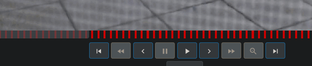

Plus, I also reported that the red activity bars at the bottom of the event display window where sporadic though mostly missing.
It seems the Pause button works now, with a caveat. When I resume/Play, the video zips in fast motion, catching up to where it would have been had the pause not been pressed. Also, repeating an event that has been previously paused will also show in fast motion.
Also, it appears the 'red activity' bars have made a somewhat consistent return.

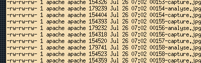

It appears that the red blocks only show on images that have alarm 'red outline', as in, images that have been stored with 'analyse' in the filename, as opposed to 'capture'.
Personally, I would like to see the 'analyse' images in the event, when there is one to a corresponding 'capture' image - so that the red outline shows in the videos, like it used to. ie, if there is an 'analyse' image, show it in preference to the 'capture' image, when the image number is the same.

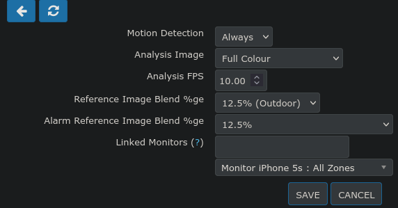

The bars are pulled from the database. Specifically the Frames table. Nothing to do with analysis jpegs, but if you aren't doing analysis, you don''t get either.
lyallp
Posts: 137
Location: Adelaide, Australia
Re: 1.37.19 - Pause button works and red activty bars are back
Post by lyallp »
I gather I do do analysis, as the images are stored, with the red motion outlines.
Is that not the case?
Is there some setting I should enable?
