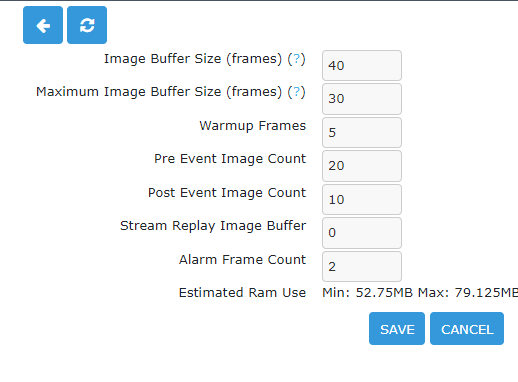

Not sure what is going on here, but I've got a camera set up with the following buffer config:
2022-08-04 09_30_53-MeadowCourt - Monitor - 23 Springdale - Garage - Brave.png
2022-08-04 09_30_53-MeadowCourt - Monitor - 23 Springdale - Garage - Brave.png (13.41 KiB) Viewed 7806 times

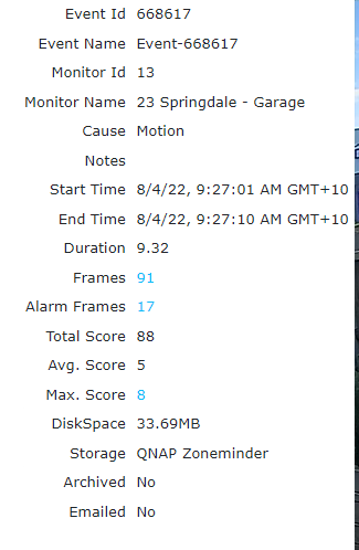

It is correctly generating an event on movement with the shown alarm frames etc:
2022-08-04 09_32_37-MeadowCourt - Event 668617 - Brave.png (18.66 KiB) Viewed 7806 times

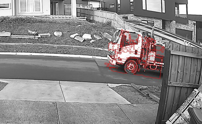

I can see the vehicle in the alarm frame:
2022-08-04 09_34_10-MeadowCourt - Frame - 668617 - 1 - Brave.png (410.26 KiB) Viewed 7806 times

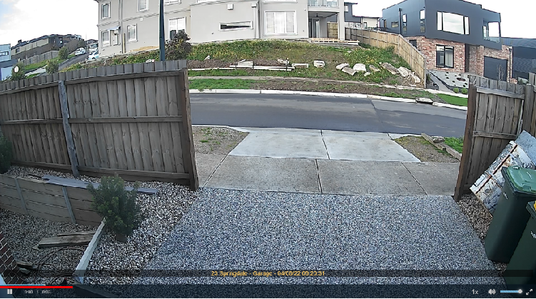

Could not attach a screenshot of video showing no vehicle in the original post, so followed up here
2022-08-04 09_41_41-ScreenToGif - Editor.png (800.54 KiB) Viewed 7805 times

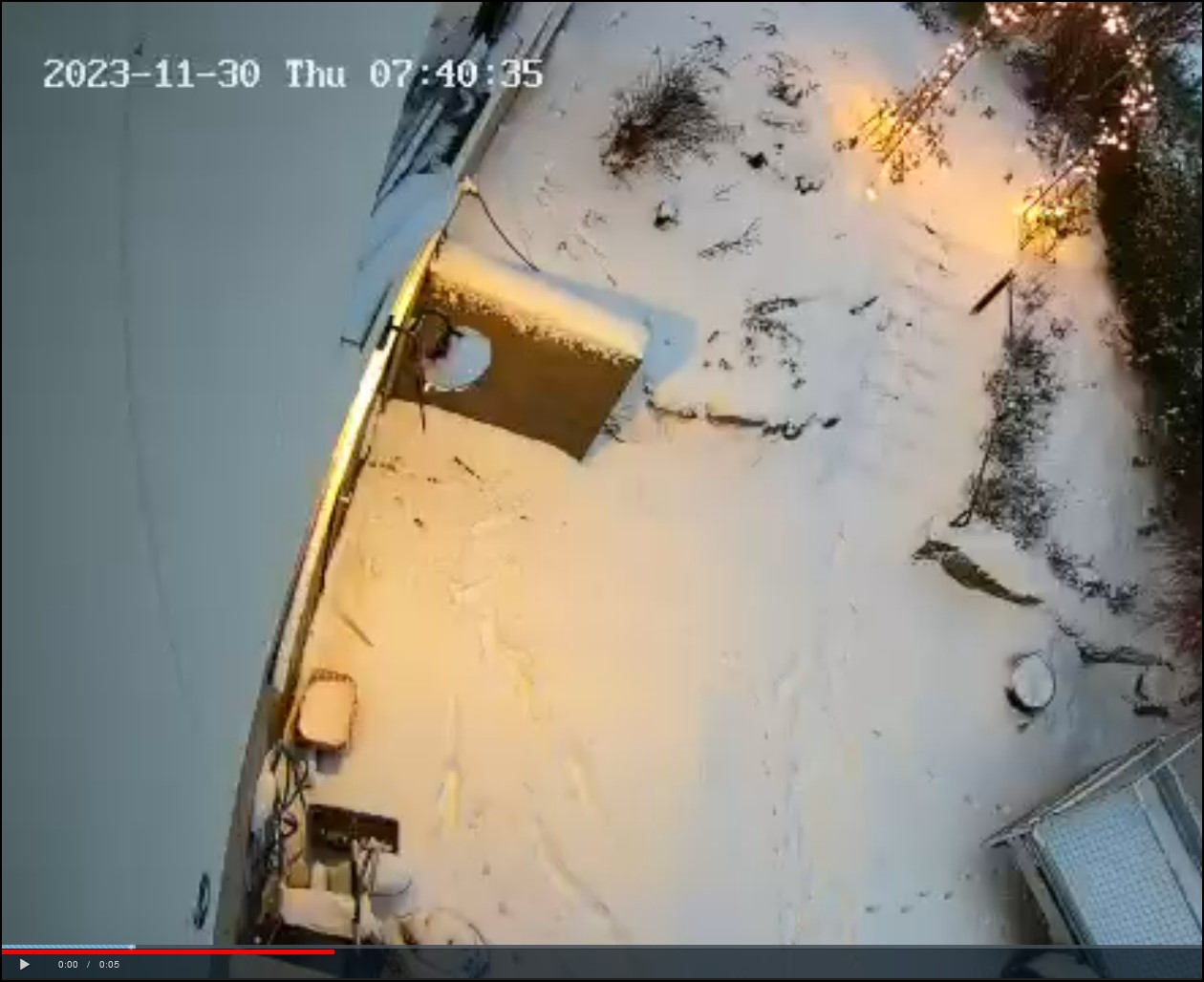

Seems like the video starts a few seconds after the alarm is triggered.

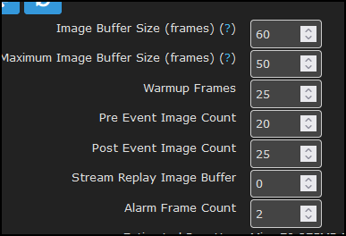

These are my settings:
Also i'm using Camera passthrough

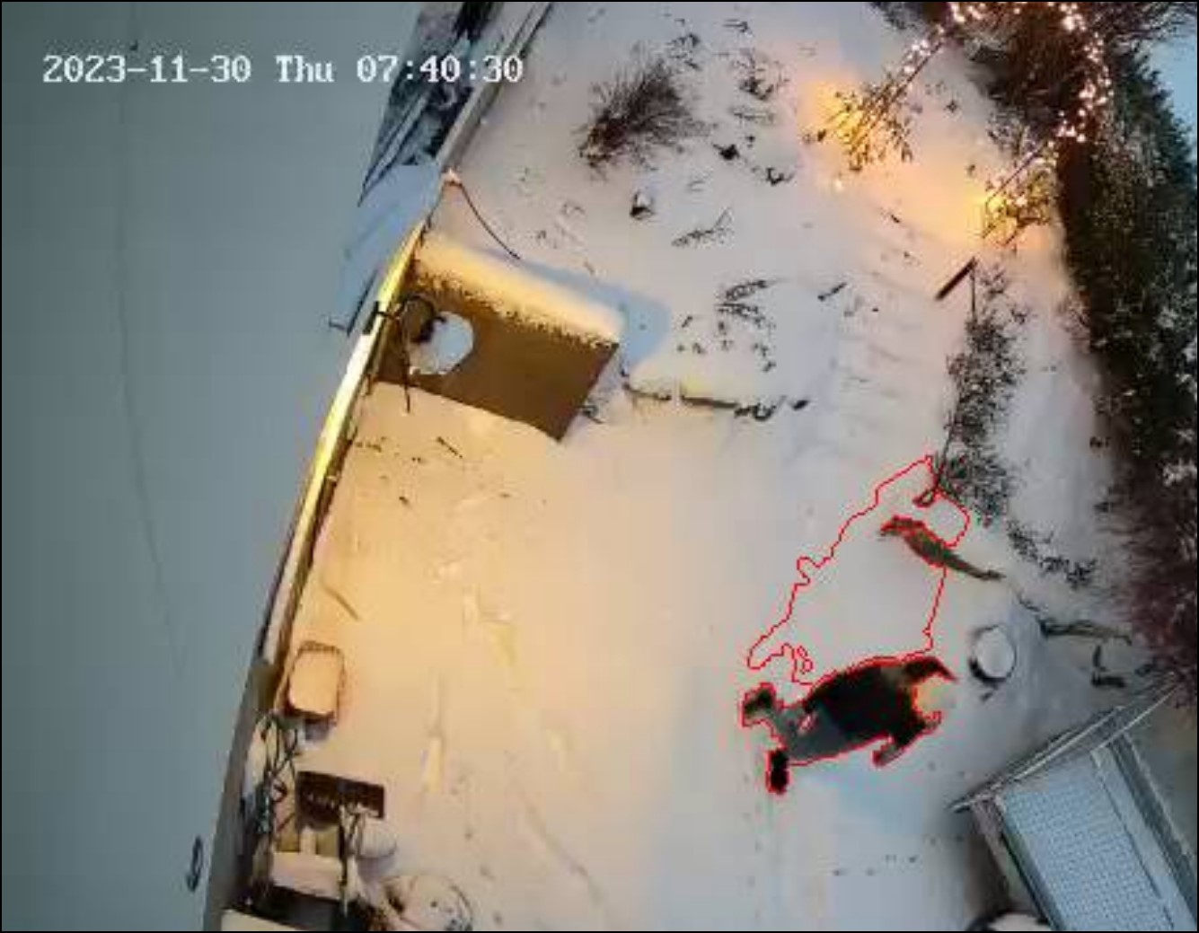

The alarm frame:
alarm frame.jpg (178.24 KiB) Viewed 7639 times
And the video missing the alarm:

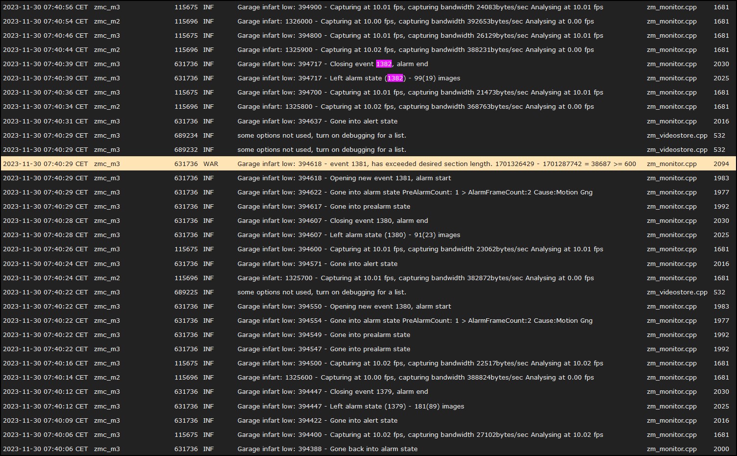

Re: Event firing, alarm frames present, but video missing movement
You both have a crazy high ImageBufferCount, likely because your systems didn't automatically adjust it during an upgrade to 1.36. That defaults to 3 now. You might realistically set it to 5 if video playback isn't smooth. Setting it so high means your system will be using a lot of ram unnecessarily.
Please look in your logs. I am suspecting that there are complaints about dropping packets from queue and not keeping up.

The logs shows the following details during the alarm:
(above alarm event code is: 1382)
If i change the ImageBufferCount down to 3, how long will the recordings be before the alarm goes off?
I want the recording to store a few seconds before the alarm goes off, in this case 20 pre event image count with a fps of 10 gives me 2 seconds.
The documentation tells me that pre event image count should not exceed half the ring buffer size=Image Buffer Size?
