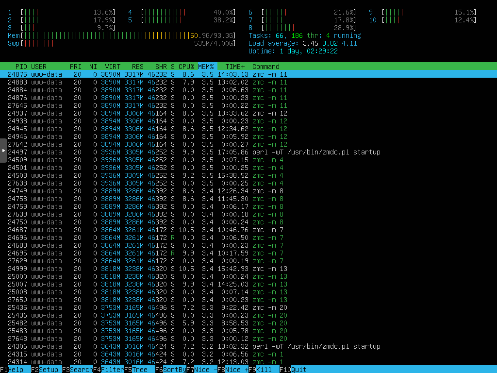

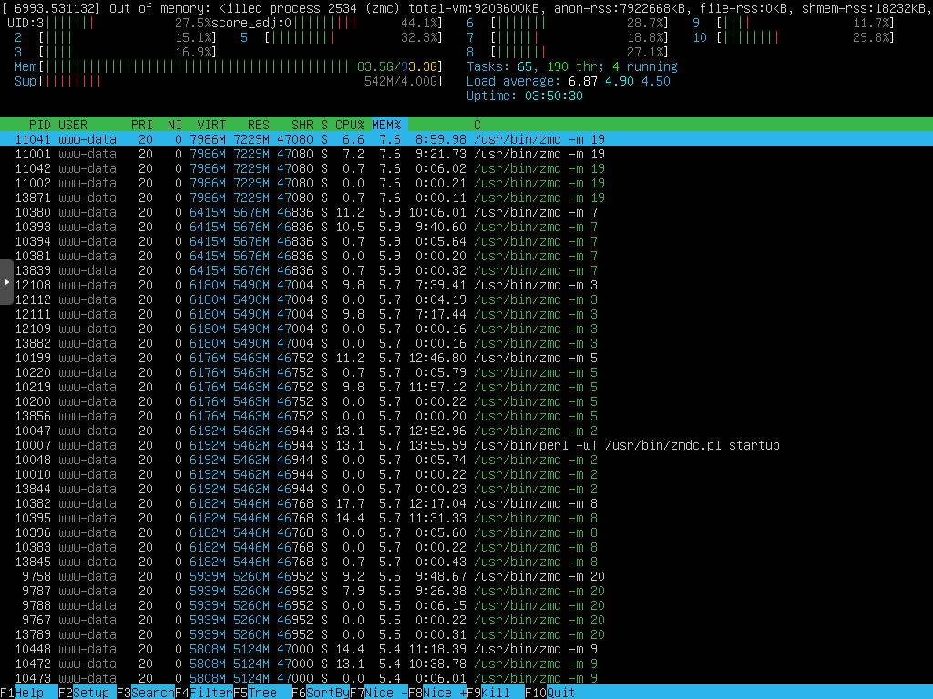

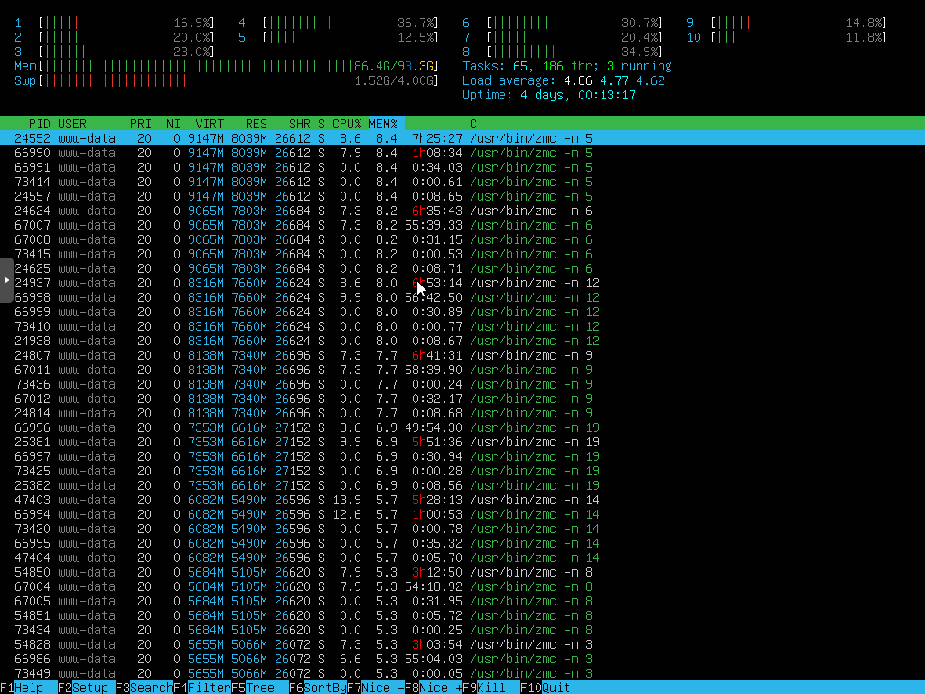

I dont have a lot of experience in these kinds of stuff. I tried to take htop ss's 3 days apart. Maybe someone can identify why the cameras have increasing ram requirements.
Edit: Ubuntu 20.04 - Zoneminder 1.36.21, All cameras H264+ Hikvision, Min Buffer 3, Max. Buffer 300, Calculated Max. Ram per camera is 3,5Gb.
Configuration is almost default.
This is couple hours of runtime.
This is 4 days+ runtime.
Posts: 3361
Re: Memory Leak/Increase and Choppy events due to Maximum Image Buffer Size
Does it actually keep increasing or does it just max out at a large value?

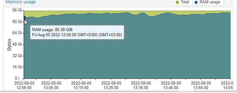

Hello once more;
I see that the memory has been stabilized at about 80gb. There seems to be no memory leak.
For some reason it went up to 110gb, then dropped down to 80gb over 3 days. After that its been stable at around 80gb.
In the past I had 96gb instead of 128gb. Maybe because I did not have enough ram for this period before stabilizing my system was seizing.
Thank you for your helps.
