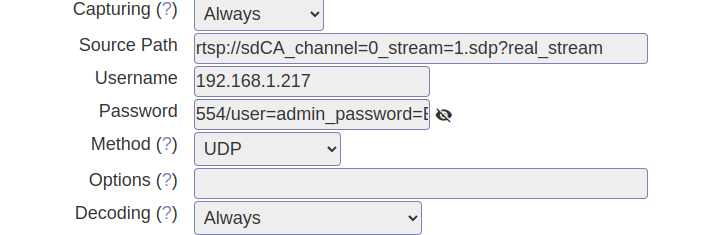

How do I cram this from 1.36.25 into .21?
rtsp://192.168.1.217:554/user=admin_password=Buffy4@sdCA_channel=0_stream=1.sdp?real_stream
gave
Screenshot from 2022-09-13 01-58-19.png (33.84 KiB) Viewed 2656 times

Yes, but that's not really part of the the URL, is it? anyway I changed it in 1.36 and copy/paste into 1.37, and it does this:

but it doesn't work on either...because the camera wants the plain @, I suppose.
This works in 1.36
Screenshot from 2022-09-13 22-18-55.png (40.47 KiB) Viewed 2615 times

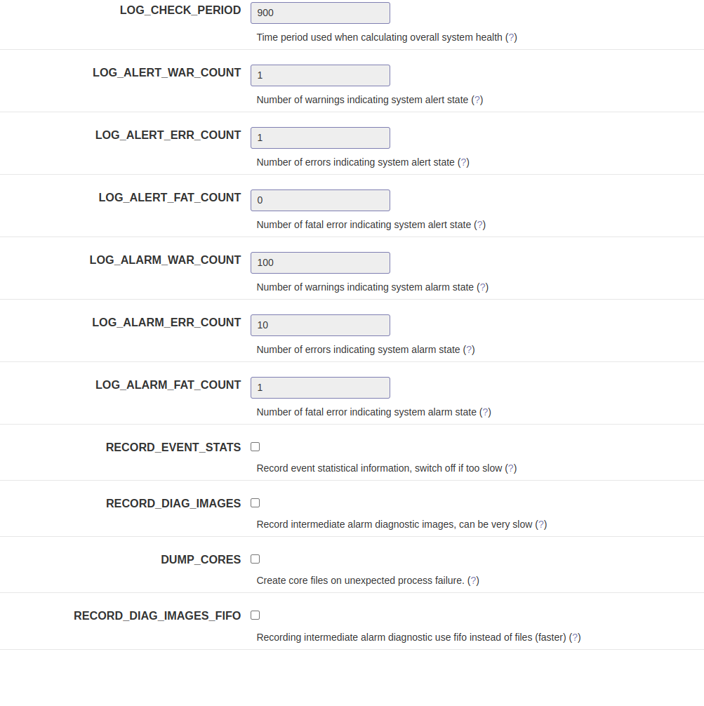

Options->Logging->ZM_DEBUG checked (LOG_DEBUG ?)
LOG_DEBUG_TARGET => clear or _zmc
LOG_DEBUG_LEVEL => 3
So maybe something else is wonky?
Screenshot from 2022-09-16 13-47-18.png (81.76 KiB) Viewed 2502 times
Screenshot from 2022-09-16 13-48-02.png (98.57 KiB) Viewed 2502 times
then
$ sudo service zoneminder restart
And even a reboot...
and LOG_DEBUG_TARGET blank and _zmc along with LOG_DEBUG_LEVEL UP TO 9
So I'm at a loss.

Ok, LOG_LEVEL_FILE also needs to be set to DEBUG
