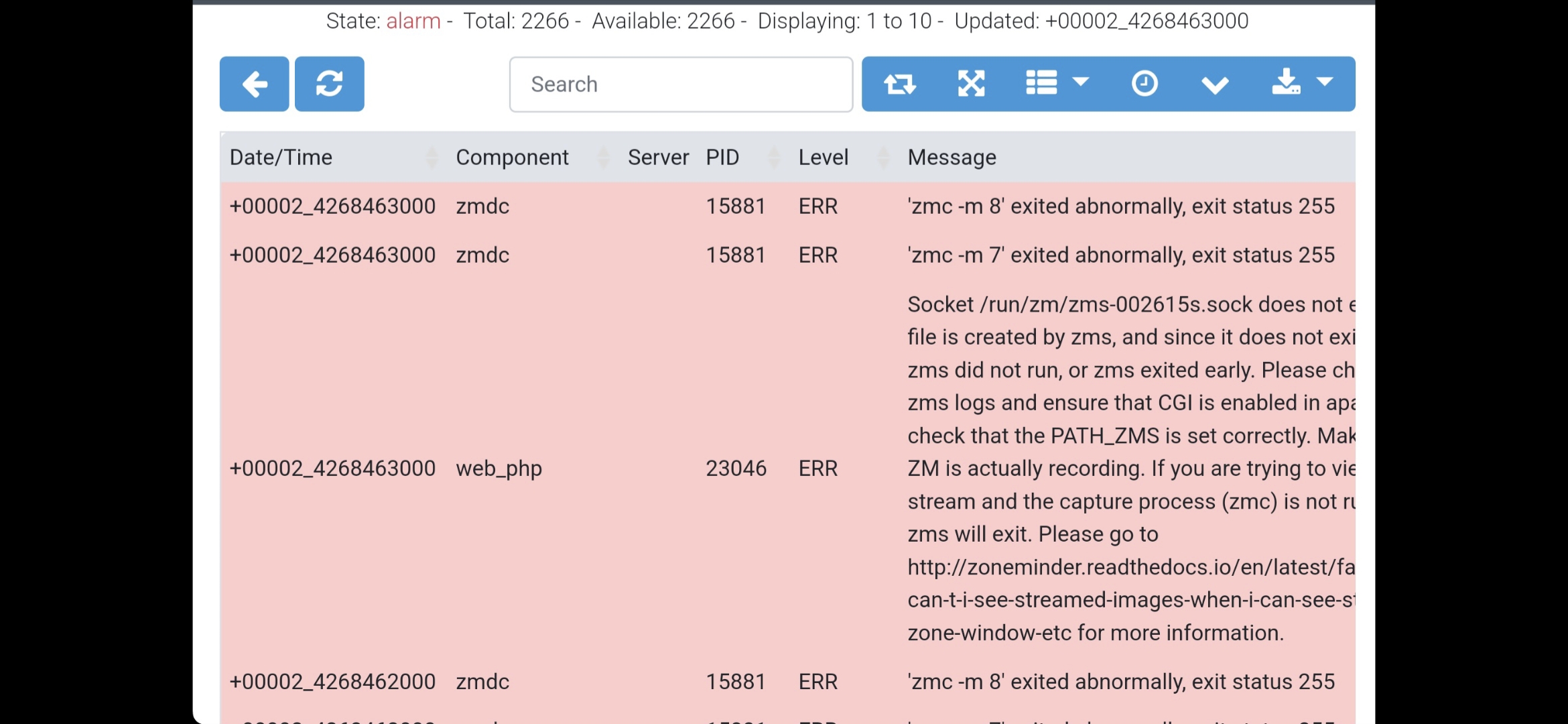

Just tried this again with 1.36.33, zoneminder stops recording, unable to view streams, all the same symptoms as the issues at the start of this thread, with the most noticeable thing being all dates and times on the log displayed on the Web interface are listed like:
+00002_4266876000
Guessing whatever is causing this is the reason everything else doesn't work.
Running Debian 10 with PHP7.3
Tried reinstalling php7.3-intl no change
Got to be something simple but can't work it out!
Screenshot attached. It doesn't even seem to be a Unix timestamp, as that would make it the year 2136!
Again, if I go back to 1.36.18, everything works perfectly.
+00002_4266876000
