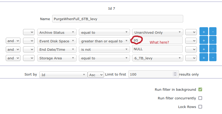

Still a problem. As it does not work to use "Disk percent" in the filter I use "Event disk space" instead. Now I'm in doubt what to put in the next field. Now I have left it to 95 which obviously is not correct as filter keeps removing even disk is 84%. Should it be Mbytes, Gbytes, bytes or what. I did not find any info about that. Any clue?
Posts: 3361
Re: PurgeWhenFull no longer works for my events disk
Event DIsk Space matches the space taken up by individual events. Put it back to just Disk Space

Post by uuhi »
Thank you for your attention. I changed filter back to Disk Percent. Mysteriously it seems to be working now. If I test the filter by clicking "List Matches" I get no results. However, in the zmfilter_7.log I can see it actually deletes events.
