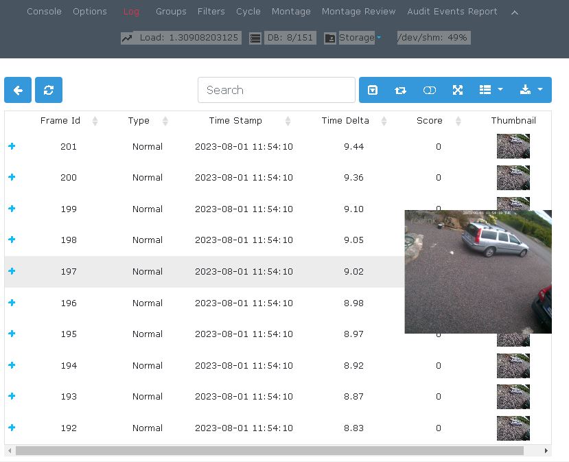

I'm trying to migrate from one ZM server to another.
The old one is running ZM v1.34.26 and the new one v1.36.12.
The OS is Ubuntu server.
The cameras are Reolink RLC-410-5MP.
I'm trying to migrate from one ZoneMinder server to another. There won't be any data migrated, only the functions. The old ZM server is v1.34.26 and installed on Ubuntu 20.04, while the new one is ZM v1.36.12 and installed on Ubuntu 22.04.
There's one problem with the new server: Reolink RLC-410-5MP cameras will not display any image with the same settings as in the old server. ZM can connect to the RLC-410, and you can see that it captures data, but there's no image. If you trigger an alarm and go to the frame-by-frame page in the UI, you can see thumbnails of each frame, but nothing more than that.
I can catch the video stream in VLC with the same connection string as in the old server.
Any idea what might be causing this problem?
//marsk

This is not working either:
//marsk
marsk
Posts: 6
Joined: Sun Jul 30, 2023 4:05 am
Re: Reolink RLC-410 Data Streams
Post by marsk »
As you can see is it captur some sort of image.
//marsk
Looks like the capture is crashing. I’d expect the logs to reflect it.
