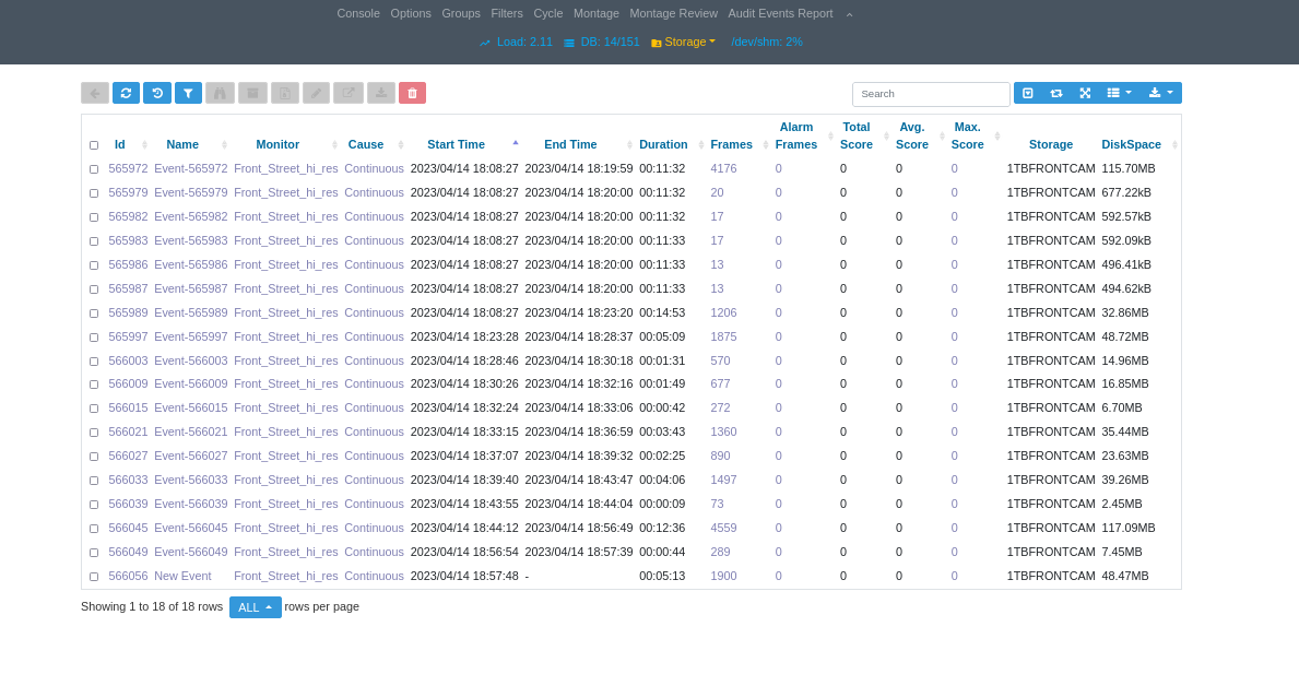

I'm getting occasional short events, that look something like picture attached. I'm going to try enabling hw decoding
as recommended above to see if that resolves it. Notice that some of these are kB, and the time/date is wrong. That's something (probably memory) breaking. I'll have to investigate. I also tried increasing the image buffer to 50 from 20. It seems to give more warnings when it's set to 50, though it's not affecting the recordings. Maybe that isn't required. I have plenty of RAM/CPU though, so it shouldn't hurt.
A weird thing: the logs option is missing on the top bar. Though I can go to it by typing log in the url. However, it only shows results
for zmtelemetry, even when set to debug for the weblog. I am using devuan, but I hope that's not the cause.
Later short events that aren't kB are from me restarting zm, those can be ignored.
- possiblememoryleak.png (157.39 KiB) Viewed 1912 times
