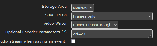

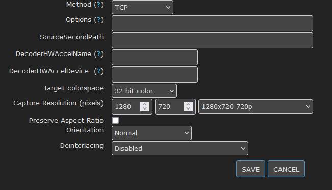

Hi all,
To give a brief rundown of my current setup I have a Proxmox Cluster with Ceph storage, and Zoneminder as a VM. I have 32cores dedicated to it, and 60gb of ram. I have TrueNas on a baremetal server with 57TB of space, with a 10gb link between them. We currently have 45 720p PoE cameras, with plans to possibly add more.
We originally were using Milestone xProtect, but we hated it and was way over priced and license BS, so I've been attempting to get Zoneminder properly setup for a month or two now but I run into numerous issues at every step when attempting to fix something else. We only need the recording footage to look back on any possible issues or security, nothing too official or too fancy, just timestamps on the footage, for just HR confirmation of any events that happened.
I originally installed it as 1.34.25 and got it mostly working but still had some glaring issues like API refusing to work, recording footage is choppy or had large 10second jumps, H264 passthrough makes the footage 1-2 frames per 5 seconds, or montage review would crash and bring us to a white screen when ever trying to load more than 1 camera of footage. Once I finally got the recording working properly, which was by disabling Saving Jpegs on each monitor, then i think thats what caused montage review to bug out but not sure.
So, I upgraded ZM to 1.36.33. This brought a few other issues but fixed the H264 passthrough, unfortunately it doesn't have the timestamps, which I know should be done through the Cameras anyways, but since they're on a VLAN, it was easier for ZM to just do it. Now, encoding produces pretty choppy footage, and has been cutting my footage into 10-20s, or even 1-5s long events when set on Mocord. I then re-enabled Frames Only for Jpegs and I think that might have fixed the montage review issue.
Anyways, apologies for kind of just rambling but I'm at a lost at what I'm doing wrong or what the proper setup should be, I just want to get this done so I can get on with the rest of my job. I'll attach pictures of an example of what my current setup is, if you have any recommendations for any of the issues I've said please let me know before I go any more insane, much appreciated.

- Source.png (11.63 KiB) Viewed 5619 times
- storage.png (5.76 KiB) Viewed 5619 times
- Buffer.png (8.53 KiB) Viewed 5619 times

Hi! Wy have some installations with over 60 cameras each. I think your problems is the buffers allocation. We have 3, 0, 0, 0, 0, 0, 1. And save jpegs is disabled. 20fps set in the cameras. It works quite well this way.
