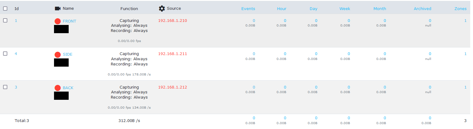

Just updated to 1.37.43 (zoneminder:amd64 (1.37.43~20230825124927-jammy) and cameras stopped working/recording. Looks like ZoneMinder will try to connect to the cameras and maybe get an image or two then stop. Everything was working normally prior to the update (1.37.42~20230810110346-jammy).
ZoneMinder console shows:
2023-09-10 10_43_46-ZM - Console.png (19.68 KiB) Viewed 13902 times
I cleared out all of my events prior to upgrading, which is why there's none shown.

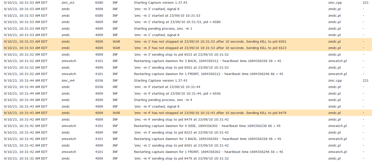

The Log is showing that it's killing zmc constantly, see the following snippet. This is repeated over and over:
2023-09-10 10_35_25-ZM - System Log.png (64.38 KiB) Viewed 13902 times
Monitoring the processes, zmc appears to start, jump to near full cpu usage and then gets killed about a minute after starting:
