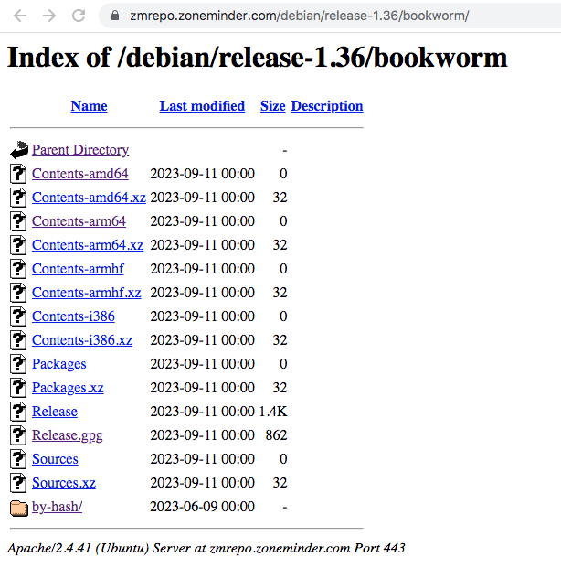

With my Debian bookworm box, I do a sudo apt-get update as I usually do. However, I encounter a no route to host error. What seems to be odd is the file sizes in the directory concerned. Any idea is welcome. Ta
Ign:6 https://zmrepo.zoneminder.com/debian/release-1.36 bookworm/ InRelease
Err:6 https://zmrepo.zoneminder.com/debian/release-1.36 bookworm/ InRelease
Could not connect to zmrepo.zoneminder.com:443 (158.69.226.113). - connect (113: No route to host)
Reading package lists... Done
W: Failed to fetch https://zmrepo.zoneminder.com/debian/release-1.36/bookworm/InRelease Could not connect to zmrepo.zoneminder.com:443 (158.69.226.113). - connect (113: No route to host)
W: Some index files failed to download. They have been ignored, or old ones used instead.

[SOLVED] Re: No Route to Host
My (Tue Sep 12, 2023) problem is now resolved. It possibly was a transient hiccup on the zoneminder repository. It has nothing to do with the file sizes either, at least not in this directory. I don't know enough debian repository directory structure to make a judgement.
