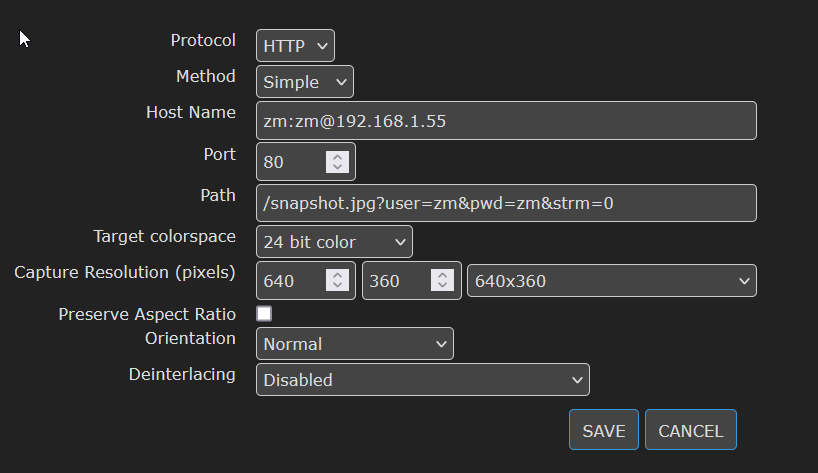

I'm trying to setup a Zosi camera (I know - it's trash) to stream snapshot JPG files into ZoneMinder.
If I go to this URL using Edge, it downloads a snapshot.jpg file:http://zm:zm@192.168.1.55/snapshot.jpg? ... =zm&strm=0
However, I have set this up in ZM using Remote source, and following:

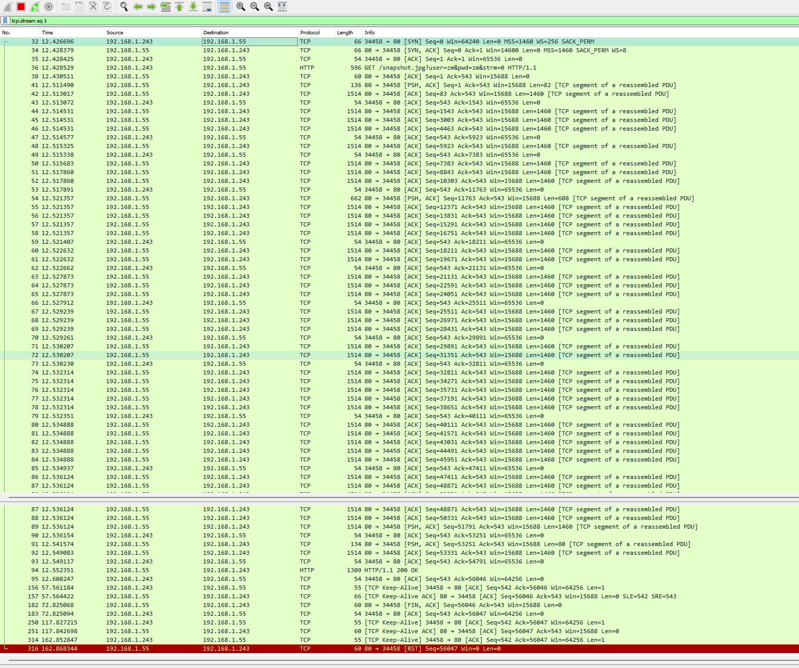

BUT - it doesn't work. A packet capture shows the HTTP interaction seems to work, but then just breaks down with ZM sending a TCP reset:

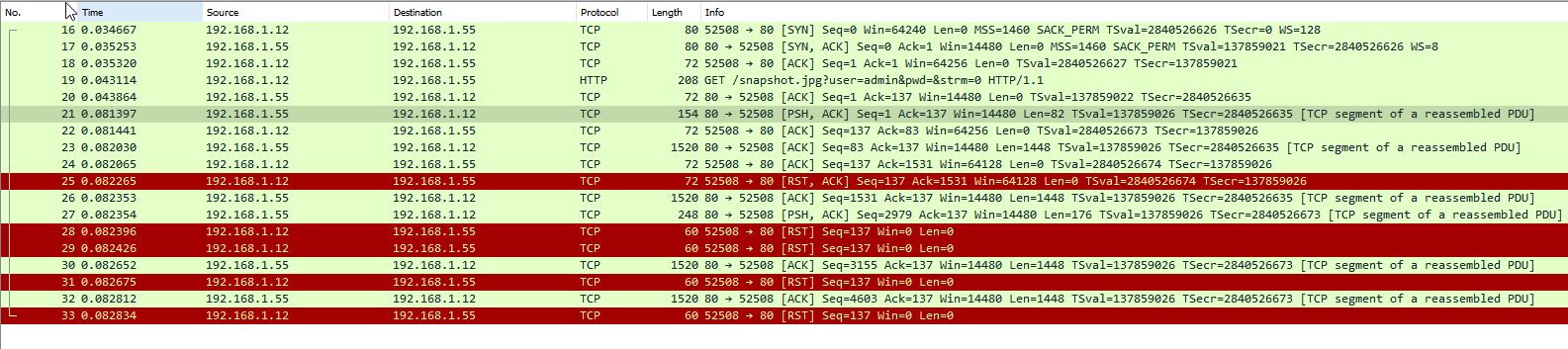

A similar packet capture from my connection with EDGE looks really similar, but with more data:
How do I get ZM to download this JPG file and use it as frames?
