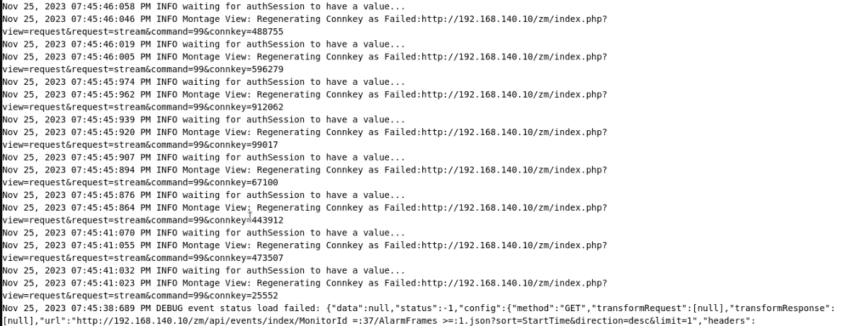

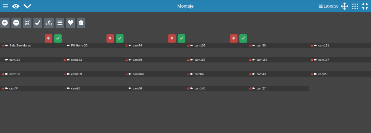

I have a situation with zmninja, all monitors are "lost" on montage (image attached). closing and reopening works for a while and then the same thing happens.
zm 1.37.45
zmninja 1.6.009
Ubuntu 22.04
The log shows this:
INFO Montagle View: Regenerating Connkey as Failed:http://192.168.140.10/zm/index.php?view ... key=617586
INFO waiting for authSession to have a value...

As I continue checking, I see that zmninja only allows 10 monitors and the rest have their ports blocked.
What will cause this blockage?

keep giving the message:
Nov 28, 2023 12:45:16:632 PM INFO Montage View: Regenerating Connkey as Failed:http://192.168.106.231/zm/index.php?
only 10 monitors are visible

When I restarted the server, the zm log stopped showing the error Failed to get semaphore for key.
but the zmninja console still shows this:
Nov 29, 2023 11:11:13:921 AM INFO Montage View: Regenerating Connkey as Failed:http://192.168.106.231/zm/index.php?view=request&request=stream&command=99&nonauth=none&connkey=625705
Nov 29, 2023 11:11:13:977 AM INFO Montage View: Regenerating Connkey as Failed:http://192.168.106.231/zm/index.php?view=request&request=stream&command=99&nonauth=none&connkey=880555
Nov 29, 2023 11:11:13:989 AM INFO Montage View: Regenerating Connkey as Failed:http://192.168.106.231/zm/index.php?view=request&request=stream&command=99&nonauth=none&connkey=288691
Nov 29, 2023 11:11:14:001 AM INFO Montage View: Regenerating Connkey as Failed:http://192.168.106.231/zm/index.php?view=request&request=stream&command=99&nonauth=none&connkey=50954
Nov 29, 2023 11:11:22:723 AM DEBUG Montage View: Stream Status check
Nov 29, 2023 11:11:23:980 AM INFO Montage View: Regenerating Connkey as Failed:http://192.168.106.231/zm/index.php?view=request&request=stream&command=99&nonauth=none&connkey=93627
Nov 29, 2023 11:11:23:998 AM INFO Montage View: Regenerating Connkey as Failed:http://192.168.106.231/zm/index.php?view=request&request=stream&command=99&nonauth=none&connkey=796772
Nov 29, 2023 11:11:24:007 AM INFO Montage View: Regenerating Connkey as Failed:http://192.168.106.231/zm/index.php?view=request&request=stream&command=99&nonauth=none&connkey=501208
Nov 29, 2023 11:11:24:022 AM INFO Montage View: Regenerating Connkey as Failed:http://192.168.106.231/zm/index.php?view=request&request=stream&command=99&nonauth=none&connkey=660530

29-11-23, 11:16:51 CLST.231122 web_php[10155].INF [192.168.140.11] [User "admin" logged out] at /usr/share/zoneminder/www/includes/auth.php line 113
29-11-23, 11:18:11 CLST.756846 web_php[10496].INF [192.168.140.11] [User "admin" logged out] at /usr/share/zoneminder/www/includes/auth.php line 113
29-11-23, 11:27:30 CLST.973221 web_php[11250].INF [192.168.120.60] [User "admin" logged out] at /usr/share/zoneminder/www/includes/auth.php line 113
29-11-23, 11:28:49 CLST.414321 web_php[11500].INF [192.168.120.60] [User "admin" logged out] at /usr/share/zoneminder/www/includes/auth.php line 113
29-11-23, 11:38:54 CLST.033872 web_php[12224].INF [192.168.120.60] [Login successful for user "admin"] at /usr/share/zoneminder/www/includes/auth.php line 459
29-11-23, 11:39:17 CLST.876808 web_php[12885].INF [192.168.120.60] [User "no one" logged out] at /usr/share/zoneminder/www/includes/auth.php line 113
29-11-23, 11:40:48 CLST.525808 web_php[13146].ERR [192.168.120.60] [Timed out waiting for msg /run/zm/zms-934925s.sock after waiting 5000 seconds] at /usr/share/zoneminder/www/ajax/stream.php line 124
29-11-23, 11:40:48 CLST.529063 web_php[13151].ERR [192.168.120.60] [Timed out waiting for msg /run/zm/zms-748723s.sock after waiting 5000 seconds] at /usr/share/zoneminder/www/ajax/stream.php line 124
29-11-23, 11:40:48 CLST.528743 web_php[13212].ERR [192.168.120.60] [Timed out waiting for msg /run/zm/zms-031774s.sock after waiting 5000 seconds] at /usr/share/zoneminder/www/ajax/stream.php line 124
29-11-23, 11:40:48 CLST.615482 web_php[12859].ERR [192.168.120.60] [Timed out waiting for msg /run/zm/zms-883346s.sock after waiting 5000 seconds] at /usr/share/zoneminder/www/ajax/stream.php line 124
29-11-23, 12:00:29 CLST.485763 web_php[18708].ERR [192.168.140.11] [Timed out waiting for msg /run/zm/zms-737324s.sock after waiting 5000 seconds] at /usr/share/zoneminder/www/ajax/stream.php line 124
29-11-23, 12:00:29 CLST.496958 web_php[18465].ERR [192.168.140.11] [Timed out waiting for msg /run/zm/zms-904442s.sock after waiting 5000 seconds] at /usr/share/zoneminder/www/ajax/stream.php line 124
29-11-23, 12:04:52 CLST.573844 web_php[20002].ERR [192.168.120.60] [Timed out waiting for msg /run/zm/zms-333642s.sock after waiting 5000 seconds] at /usr/share/zoneminder/www/ajax/stream.php line 124
29-11-23, 12:11:23 CLST.814574 web_php[21112].ERR [192.168.120.60] [Timed out waiting for msg /run/zm/zms-751568s.sock after waiting 5000 seconds] at /usr/share/zoneminder/www/ajax/stream.php line 124
29-11-23, 13:59:31 CLST.303285 web_php[257540].INF [192.168.140.11] [Login successful for user "admin"] at /usr/share/zoneminder/www/includes/auth.php line 459
