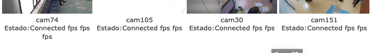

After some time the web montage stops (there is no movement in the images), in zmninja it is choppy. If I refresh the page, the image refreshes but is still stopped in v1.37.47.
Captura de Pantalla 2023-12-05 a la(s) 11.05.46.png (42.84 KiB) Viewed 82231 times
