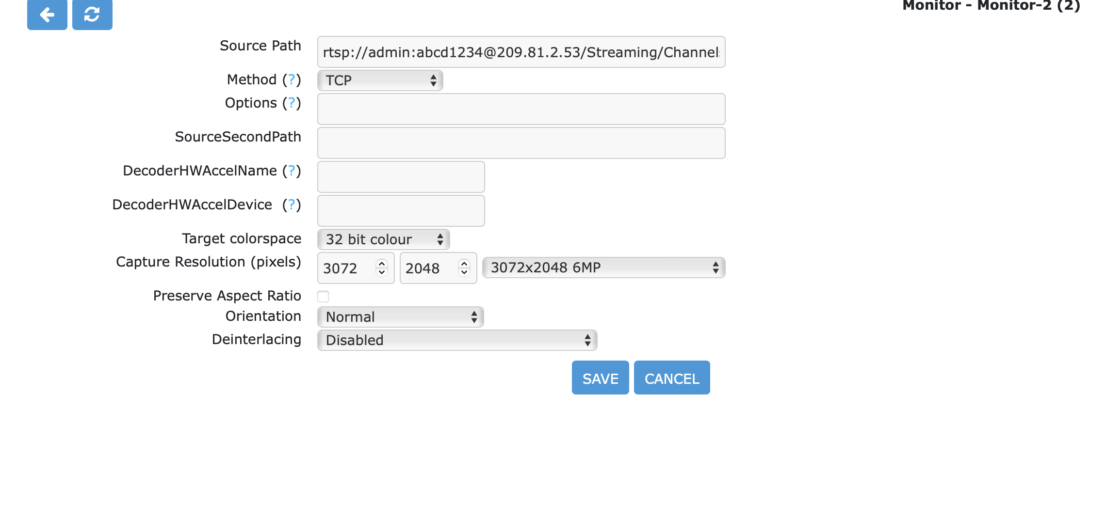

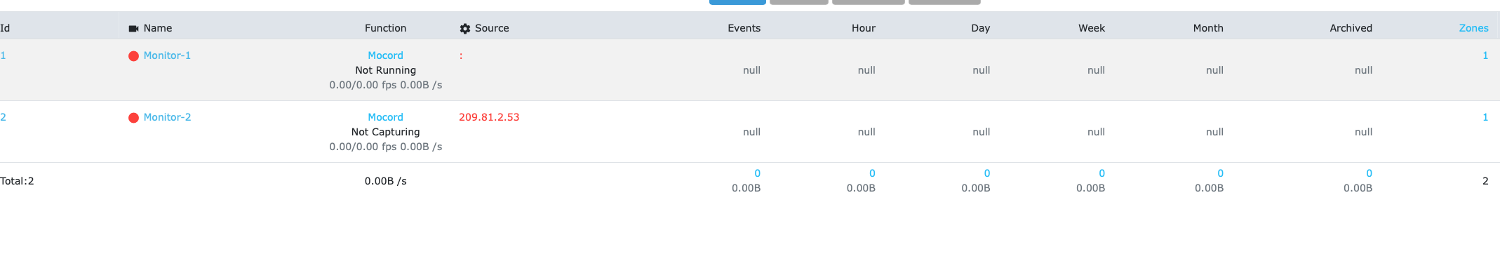

Re: ZM questions
I used a stanDalone camera tester to get the Cameras's URL.
It said the URL was rtsp://admin:abcd1234@209.81.2.53/Streaming/Channels/101
Going through the camera config pages, I don't see a button for UDP/TCP, so I have set ZM to both with
the same result... No recorded video.
When I type it into the Browser (Safari) it startes VLC and displays live video.
So, the URL works...

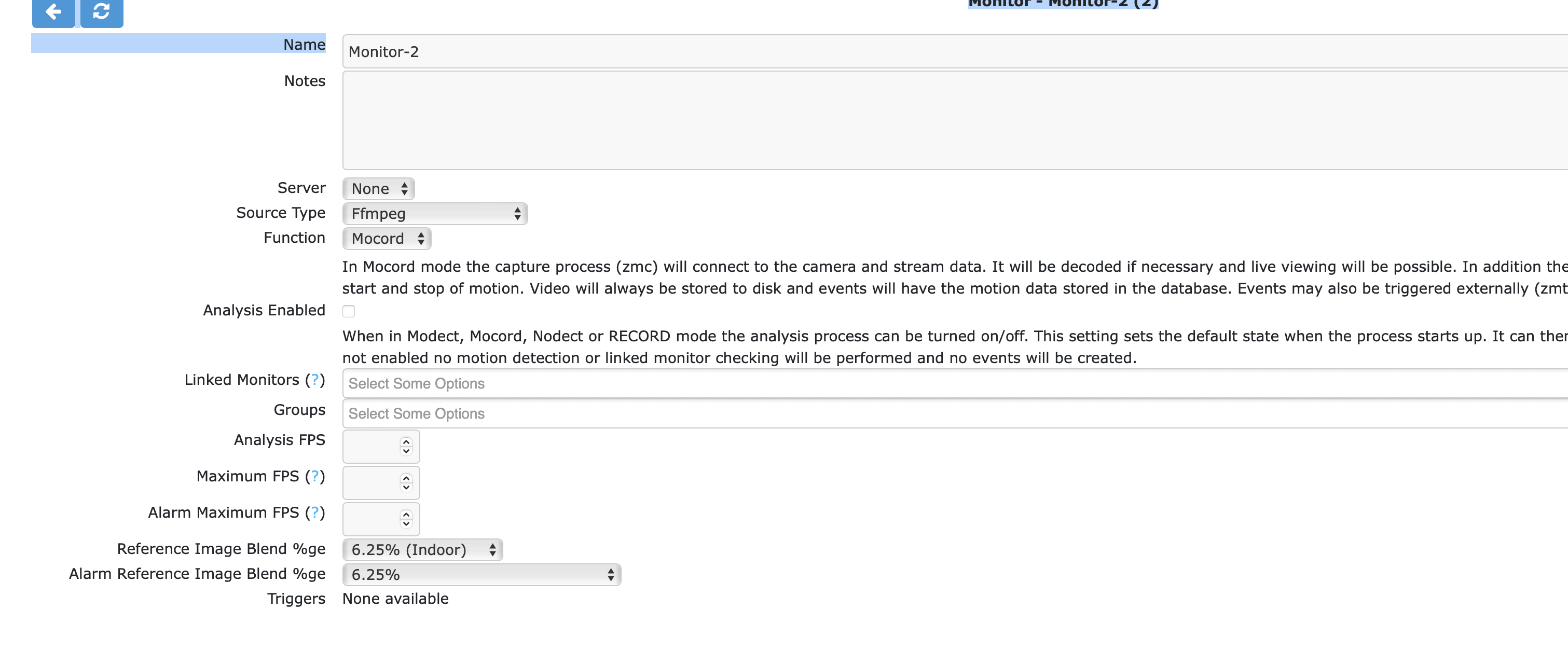

- monitor settings
- Screen Shot 2023-12-07 at 4.29.40 PM.png (52.75 KiB) Viewed 71153 times
- camera settingd
- Screen Shot 2023-12-07 at 4.28.14 PM.png (186.92 KiB) Viewed 71153 times
Re: ZM questions
Select a server for. You have selected none.
Re: ZM questions
Ok, the server button only gives me the options of "none" or "Auto". choosing Auto, then saving doesn't change anything. Does the server have to be listed in a config file somewhere?

Those logs show the monitor type as Remote and nothing entered for host... what is going on?
Select ffmpeg type, put the url to the camera into the Path on Source tab...
Re: ZM questions
Monitor-1 logs are what you are seeing. I messed up the config for that monitor — thats why i created monitor-2. I can’t seem to delete/edit monitor-1

What's strange, the line that says:
rtsp://209.81.2.53/Streaming/Channels/101 due to: Connection refused
I can type thst into my browser (Safari) and it runs vlc and shows video from a camera...
