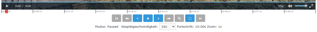

I updated to 1.37.50 today.
I manually triggered an alarm for a few seconds. After the alarm stops, the monitor will appear as idle. However, the recording continues unnoticed in the background until 10 minutes (maximum section length 600 seconds) are reached.
EVENT_CLOSE_MODE is set to idle for me.
Zoneminder_Screenshot 2024-01-24 110310.png (99.35 KiB) Viewed 3814 times
I downgrade to version 1.37.48 before January 11th, 2024 and set zoneminder back to apt-mark hold. Until this update, the yellow frame remained around the sub-monitor after an alarm, but recording was stopped. Since the update on January 11, 2024, the frame has disappeared after the alarm, but the recording continues unnoticed. The result is: Zoneminder 1.37x versions after January 11, 2024 are unusable.
