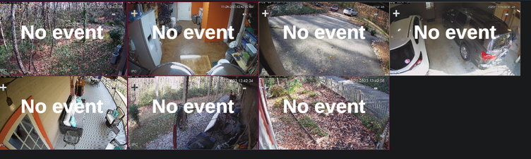

It shows no events, error in log, but I have event files
- Posts: 54
- Joined: Mon Aug 26, 2019 12:42 pm
This is the error.
Seems like it is recording and keeping data, just not seeing the events.
1.37.47
1.37.47
- Screenshot from 2023-11-22 07-09-52.png (92.93 KiB) Viewed 18692 times

Re: It shows no events, error in log, but I have event files
I believe I have the latest.
This is the Montage Review.
If I look in my zoneminder folder, I have files within the limits of my filter for age.
- Screenshot from 2023-11-23 13-42-55.png (303.56 KiB) Viewed 18635 times
It's Mocord and I selected 8hour.
I also use ZmNinja. And it just gives an error "error retrieving Event List". And shows nothing.

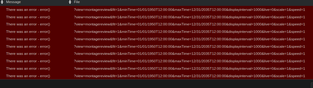

I have had some zoneminder updates, and I thought it was fixed. But now I have this.
Live cameras look fine.
If I got to Montage it seems ok, but it almost makes zoneminder lock-up
Montage Review shows no events.
And I get this error in log when I select montage.
- Screenshot from 2024-01-19 12-56-00.png (81.65 KiB) Viewed 16450 times
Generally that is caused by api not being correctly configured.
Checking the status of mysql
systemctl status apache2 mysql --no-pager -l
apache2.service - The Apache HTTP Server
Loaded: loaded (/lib/systemd/system/apache2.service; enabled; vendor preset: enabled)
Active: active (running) since Sat 2024-01-20 22:42:58 EST; 15h ago
Docs: https://httpd.apache.org/docs/2.4/
Main PID: 1248 (apache2)
Tasks: 12 (limit: 38198)
Memory: 59.5M
CPU: 11.566s
CGroup: /system.slice/apache2.service
├─ 1248 /usr/sbin/apache2 -k start
├─ 23305 /usr/sbin/apache2 -k start
├─ 23308 /usr/sbin/apache2 -k start
├─ 23309 /usr/sbin/apache2 -k start
├─280805 /usr/sbin/apache2 -k start
├─280827 /usr/sbin/apache2 -k start
├─280844 /usr/sbin/apache2 -k start
├─280872 /usr/sbin/apache2 -k start
├─281403 /usr/sbin/apache2 -k start
├─281442 /usr/sbin/apache2 -k start
├─281469 /usr/sbin/apache2 -k start
└─282003 /usr/sbin/apache2 -k start
Jan 21 14:19:42 Basement web_php[280827]: 1/21/24, 2:19:42 PM EST.490773 web_js[280827].ERR [192.168.1.30] [There%20was%20an%20error%20-%20error()] at ?view=montagereview line
Jan 21 14:19:43 Basement web_php[281442]: 1/21/24, 2:19:43 PM EST.467005 web_js[281442].ERR [192.168.1.30] [There%20was%20an%20error%20-%20error()] at ?view=montagereview line
Jan 21 14:19:43 Basement web_php[281469]: 1/21/24, 2:19:43 PM EST.467459 web_js[281469].ERR [192.168.1.30] [There%20was%20an%20error%20-%20error()] at ?view=montagereview line
Jan 21 14:19:43 Basement web_php[23305]: 1/21/24, 2:19:43 PM EST.467460 web_js[23305].ERR [192.168.1.30] [There%20was%20an%20error%20-%20error()] at ?view=montagereview line
Jan 21 14:19:43 Basement web_php[280872]: 1/21/24, 2:19:43 PM EST.468153 web_js[280872].ERR [192.168.1.30] [There%20was%20an%20error%20-%20error()] at ?view=montagereview line
Jan 21 14:19:43 Basement web_php[23308]: 1/21/24, 2:19:43 PM EST.469508 web_js[23308].ERR [192.168.1.30] [There%20was%20an%20error%20-%20error()] at ?view=montagereview line
Jan 21 14:19:43 Basement web_php[280827]: 1/21/24, 2:19:43 PM EST.470300 web_js[280827].ERR [192.168.1.30] [There%20was%20an%20error%20-%20error()] at ?view=montagereview line
Jan 21 14:19:43 Basement web_php[281442]: 1/21/24, 2:19:43 PM EST.471058 web_js[281442].ERR [192.168.1.30] [There%20was%20an%20error%20-%20error()] at ?view=montagereview line
Jan 21 14:19:43 Basement web_php[23305]: 1/21/24, 2:19:43 PM EST.474045 web_js[23305].ERR [192.168.1.30] [There%20was%20an%20error%20-%20error()] at ?view=montagereview line
Jan 21 14:19:43 Basement web_php[281469]: 1/21/24, 2:19:43 PM EST.477740 web_js[281469].ERR [192.168.1.30] [There%20was%20an%20error%20-%20error()] at ?view=montagereview line

- Posts: 54
I ended up removing and reinstalling zoneminder. All good now.
