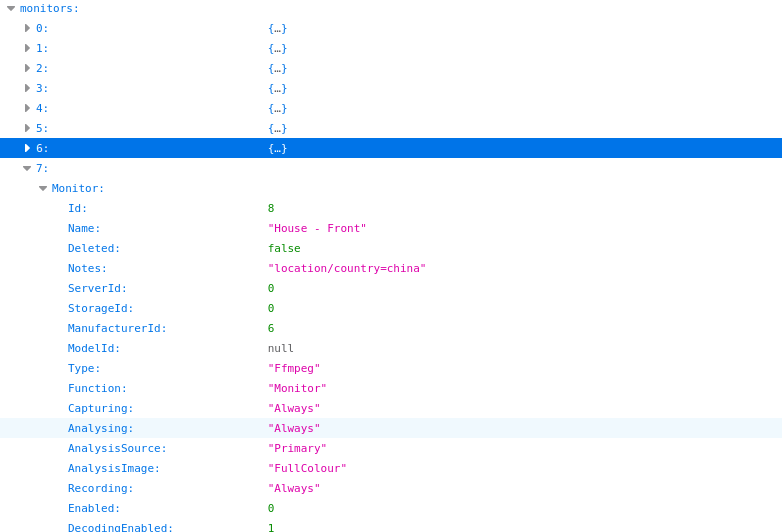

http://server/zm/api/monitors.json on the machine with zoneminder seems ok.

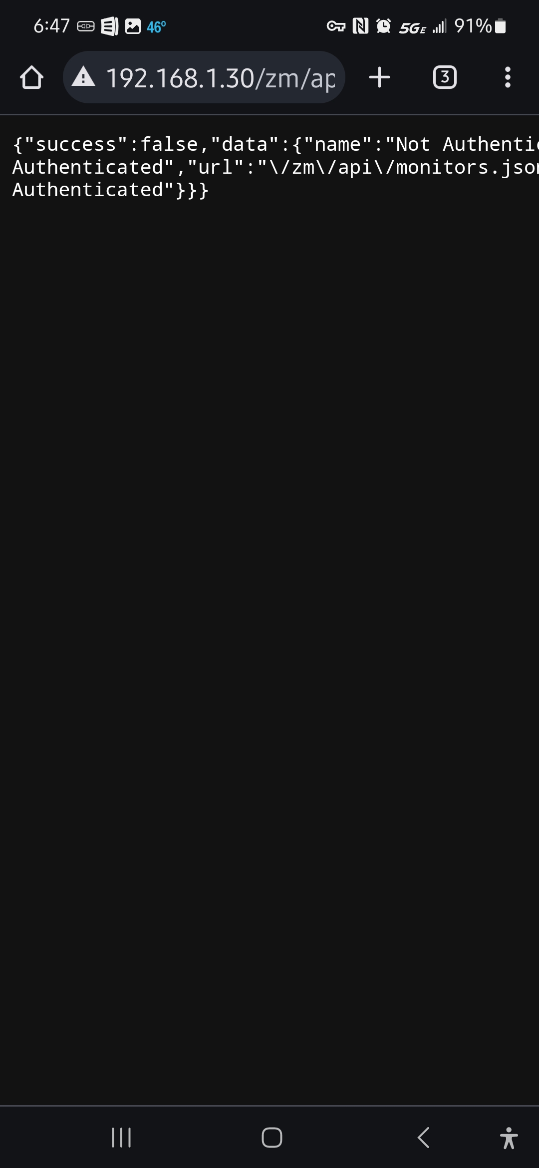

When I look at this same address on my tablet logined to zoneminder first.
It is just a bunch of strings of txt, not in the table format like my attached photo.
Screenshot from 2024-01-22 17-52-03.png (30.83 KiB) Viewed 4292 times
That surprises me. Mine looks like your posted example.

I agree, that's was on the machine running zoneminder.
My phone/tablet trying to run ZmNinja
Posts: 1380
Re: I think I have an issue with my API, not sure where to look
Just a guess, but maybe https:// ?

I can access zoneminder HTTP but not HTTPS
Posts: 1380
Yeah...ISTR something about android needing https in later versions.
Don't mean to send you down a rathole, but I suspect that's at the bottom of this.
I don't use ninja at present so that's all I got. Sorry, and good luck.
(a better screenshot of the error on phone might be helpful)

I reinstalled the older zmNinjaPro which prompts for http or https and I choose http and basically it works.
So maybe there is something with https...
Posts: 3404
http vs https shouldn't be an issue here. It only seems to affect image loading.
The response is pretty clear, Not Authenticated. The question is, why?

Not sure what I did...
I am now HTTPS with SSL and everything seems to be working
