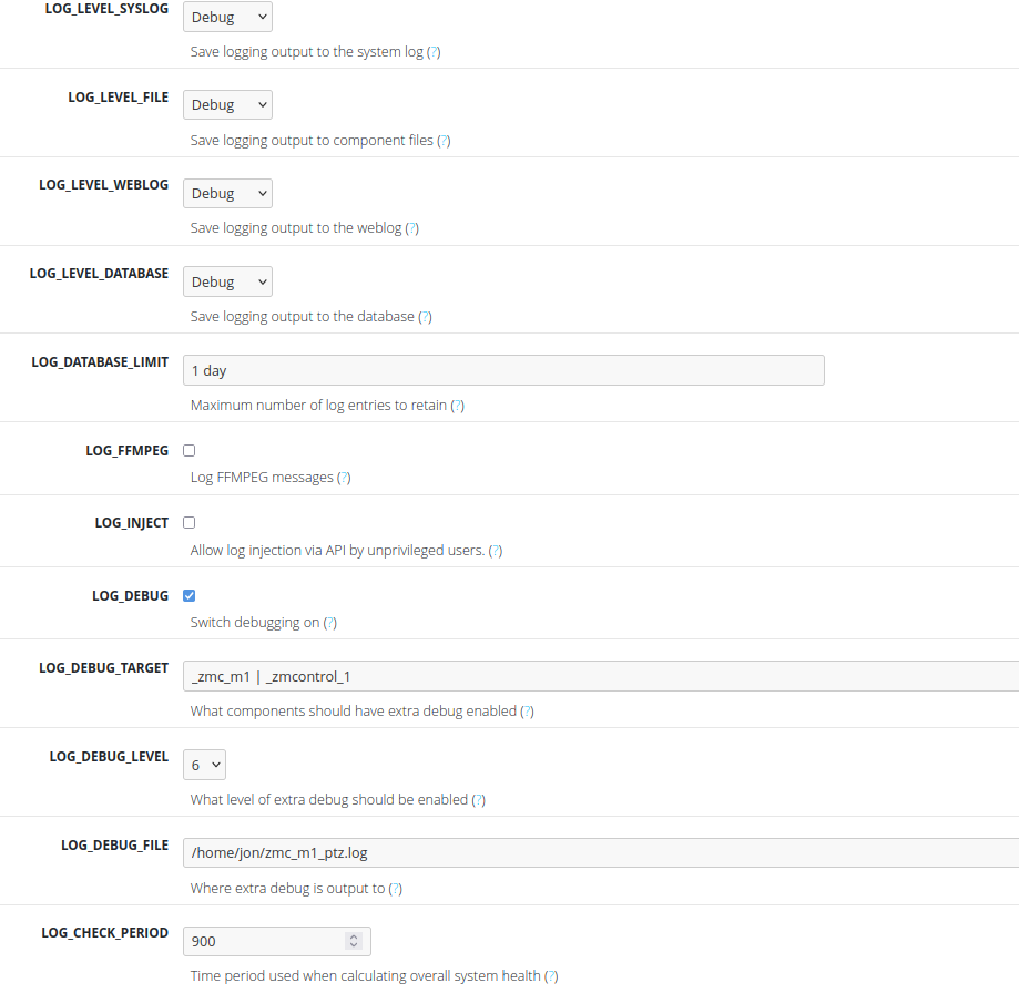

It's taken a while to get back to. I couldn't get the debug log to save where I wanted or even generate.
I put _zmc_m1 | _zmcontrol_1 in the devices to log, and /home/jon/zmc_m1_ptz.log as my log file but nothing appears even after several restarts.
- Screenshot_20231222_122541.png (82.82 KiB) Viewed 21794 times
Re: Hikvision PTZ control
It won't have permission to write to your home directory.
It wouldn't write to /var/log either so I tried /var/log/zm and still no logging output to a dedicated file as specified.

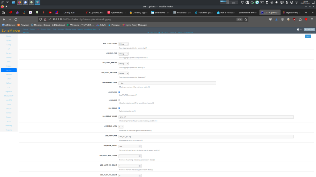

Ok, I am home and back looking at this. I have logging set as the image, but I don't get an output file. Are my logging settings ok, and are there any other components I should be logging? Since I took the image I have added _zmcontrol to the debug targets but still no joy
- zoneminder_logging.png (83.87 KiB) Viewed 15059 times
You do need to restart after changing logging settings.
I restarted several times using the button on the top right of the web page before attempting to get debug output, should it be done directly on the systemd service?
