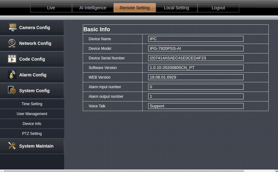

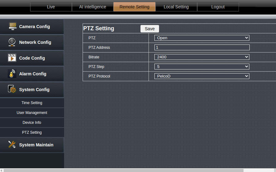

This is the camera seen directly from browser 192.168.1.180, not via ZM: (I attached 2 files, but ZM forum is duplicating attachment 1 for some reason? The attachments and the code show 2 files, not 3?)
Screenshot from 2024-03-23 18-33-57.png (83.08 KiB) Viewed 4774 times
Screenshot from 2024-03-23 18-34-45.png (98.73 KiB) Viewed 4774 times
Posts: 1379
Re: Configuring control of PTZ unclear?
Maybe I'm just not understanding what you're trying to do, but I'm afraid you've gone down a rabbit hole...
What you're looking at is the list of known cameras and what the script for it is capable of.
You select one of those for a given camera, like so:
Screenshot 2024-03-23 at 02-34-00 ZM - Monitor - Garage.png (60.17 KiB) Viewed 4769 times
Most modern cameras support onvif, and the onvif selection will work, at least a little.
HTH...

Desktop -> Browser: 192.168.1.180/rsmain.html -> camera shows PTZ Settings:
PTZ: Open
PTZ Address: 1
Bitrate: 115200
PTZ Step: 5
PTZ Protocol: PelcoD
ZoneMinder -> Source -> source Path shows: rtsp://<userName>:<password>@192.168.1.180/main.html?first=0
