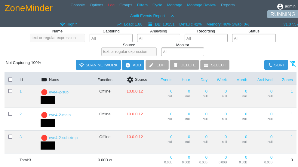

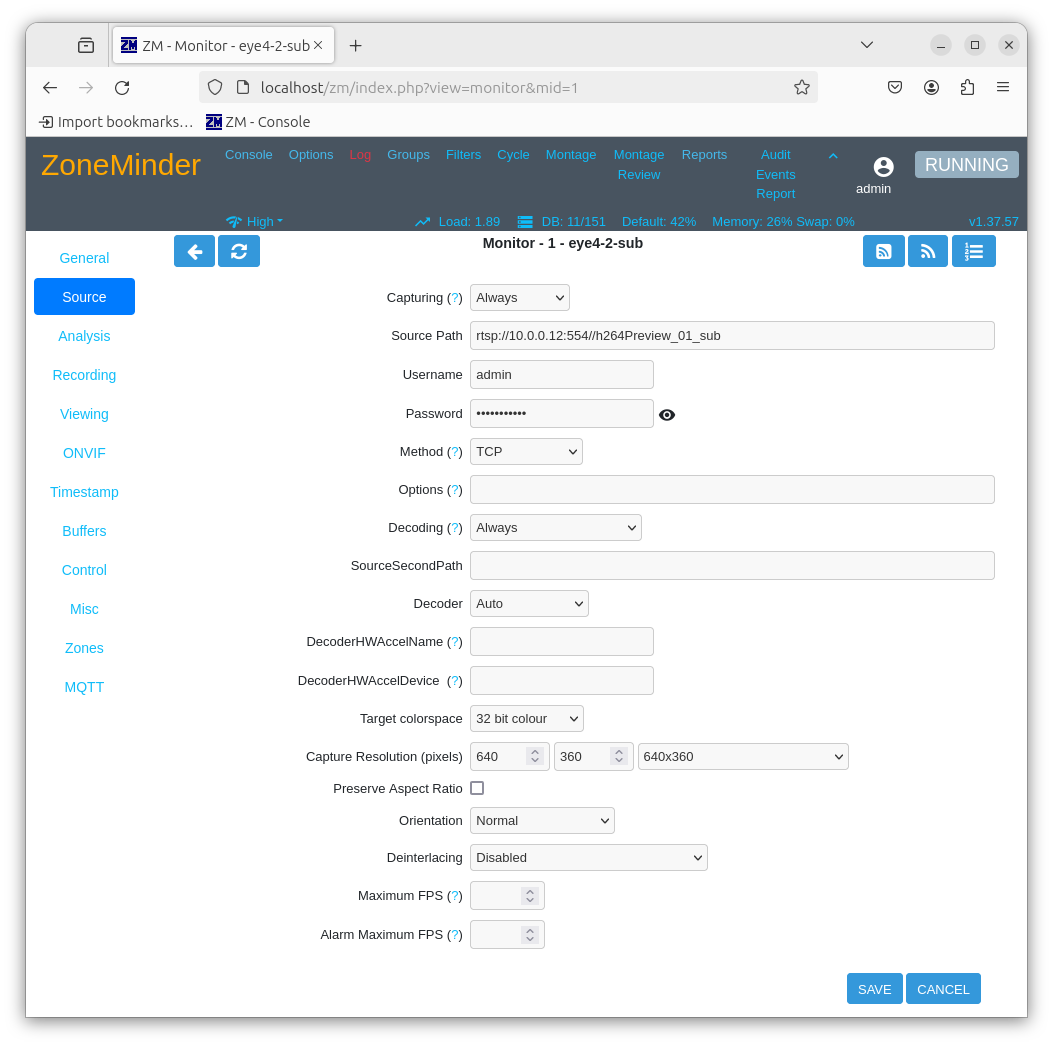

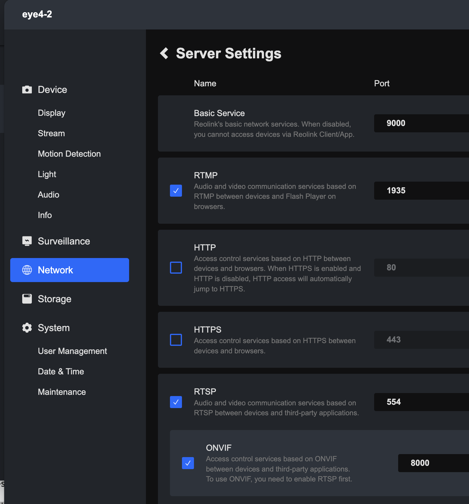

Still can't get my camera to connect to ZM, but perhaps a bit closer:
i'm following these [Reolink camera suggestions](https://wiki.zoneminder.com/Reolink#RLC-810A) for my RLC-811A camera.
and this is how I used the reolink app to set the camera's server Pinging the camera still works.
nmap only shows port 9000 open
and also shows the RTSP port closed:
I'm now at least able to have the monitors listed in the console .
The first two monitors are using RTSP on the camera's sub and main streams, specified like this . I also tried the RTMP protocol but no better results using that.
the ZM monitors' logs shows 'Connection refused' for all streams.
As you suggested, I tried using onvif probing both via ZM and using `onvif-util`, but it also cannot see the camera:
other folks are able to make these reolink cameras work via RTSP; what am I doing wrong?!
nmap -p1-65535 10.0.0.12
