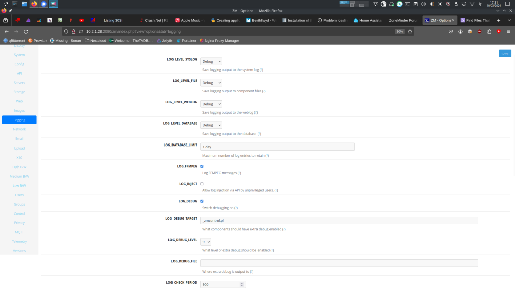

Clear log_debug_target or set it to _zmcontrol.pl, as we are not interested in zmc.

Done that, I have also done a complete machine restart as there were some updates. I even cleared the log_debug_file and nothing discernible has appeared. I even did find . -mmin -20 to see all the files created within the last 20 mins but they all appeared to be the standard logging files.

After doing a tcpdump and analysing the traffic, along with finding a copy of the ISAPI manual I could see the reason it wasn't working is because I am an idiot. Thanks for your patience with this.
In control device I was putting the device name not the id of what I wanted to control. Once I set the control device to 1 it started moving, now I just need to fine tune the control values to make sure I get decent control, as well as resolving the Multiport through Nginx Proxy Manager issue I have
