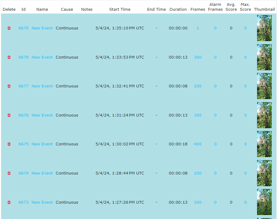

I would love to get an answer to this as well. I have the same problem and have had 0 luck fixing it.
Here is the terminal output from timedatectl
Local time: Sat 2024-05-04 09:33:57 EDT
Universal time: Sat 2024-05-04 13:33:57 UTC
RTC time: Sat 2024-05-04 13:33:57
Time zone: US/Eastern (EDT, -0400)
System clock synchronized: yes
NTP service: active
RTC in local TZ: no
I also attached a screen shot of my event log. (My events also don't close for some reason, its set to continuous record which kind of works)

- Posts: 1375
- Location: San Diego
Re: Time Zone used in Event List
Hmm.
What does your (ubuntu/linux) System->Settings->Date & Time page look like?
I'm pretty sure "US/Eastern" is not valid. Probably should be New York, United States
- Posts: 6
- Joined: Fri Mar 29, 2024 8:48 pm
You are correct it says "EDT (New York, United States)" How do I fix it in ZM to match that?
Currently under ZM/options/System Time zone is set to New York, United States

- Posts: 6
That didn't work but did get me pointed in the correct direction.
I found this documentation that didn't work.
https://zoneminder.readthedocs.io/en/st ... ebian.html
I had to change sudo nano /etc/php/7.0/apache2/php.ini
to sudo nano /etc/php/8.2/apache2/php.ini
Then find and update the time zone in the php.ini file as described in the documentation.
Then do
sudo systemctl reload apache2
sudo systemctl restart zoneminder
