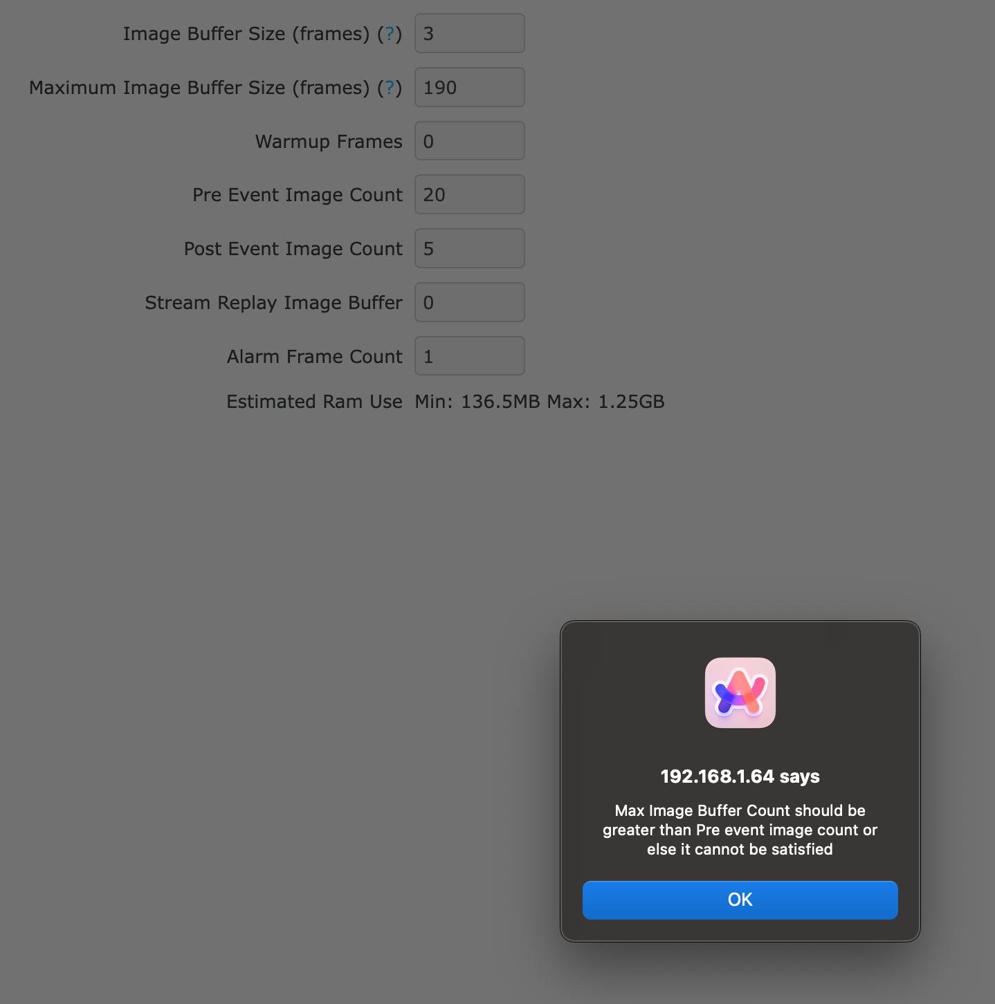

Side note: the error message about max needing to be more than pre seems to demand a 10x more. For example, if I want a pre of 20 I actually have to set the max to 200. I don't know why it's not just a simple > rather than >10x?

screenshot of error at 190 over 20.
Screenshot 2024-05-16 at 9.03.51 AM.png (264.87 KiB) Viewed 3635 times
