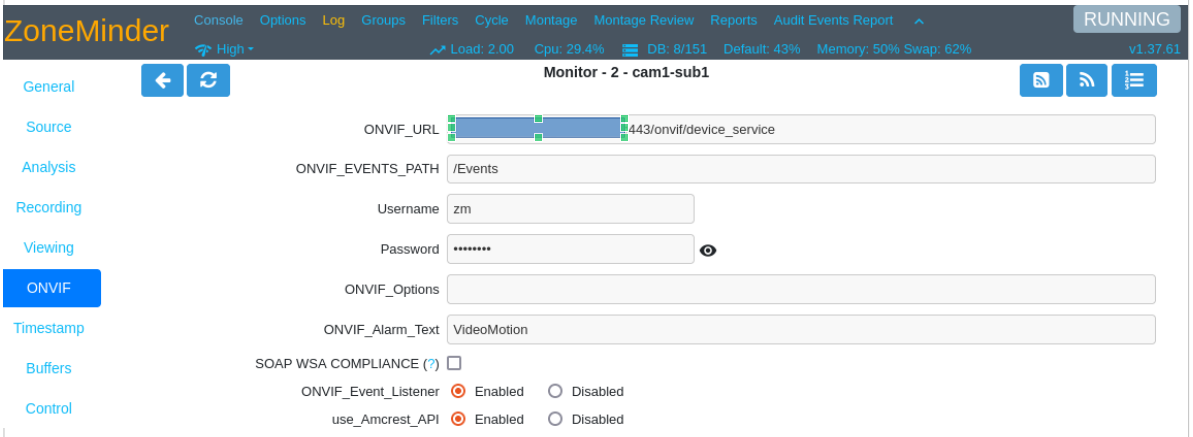

Here's my ONVIF configuration for the monitor:
![ZM onvif config]

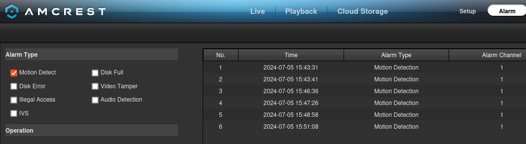

Here's a list of events as maintained by the camera:
![Amcrest camera events]

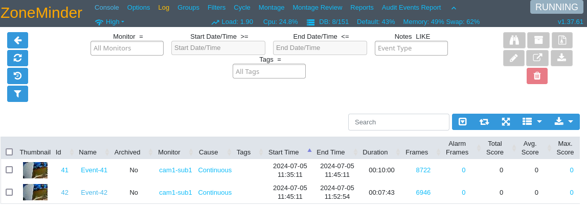

and here is the ZM list:
![ZM monitor events]
the careful observer will notice the time stamps on the ZM events are
before any of those in the Amcrest alarms; that's because the Amcrest
list refreshes everytime you login.

At first it seemed like ZM was noticing only "beginning" events, ie
considering the event to be ongoing? This made me wonder what the
"Continuous" word means in the ZM events listing?

Any ideas why only some events are being noticed by ZM? Any ideas
about how to debug further?

Continuous events are events that occur because you told it to record all the time. They are not triggered by onvif.
where am i telling this to happen?
then what would be triggering them? i have turned off all analysis.
and how about the monitor logs: what (if not onvif events) would be generating these lines?

just found the EVENT_CLOSE_MODE documentation; i think that answers my 'continuous recording' question.

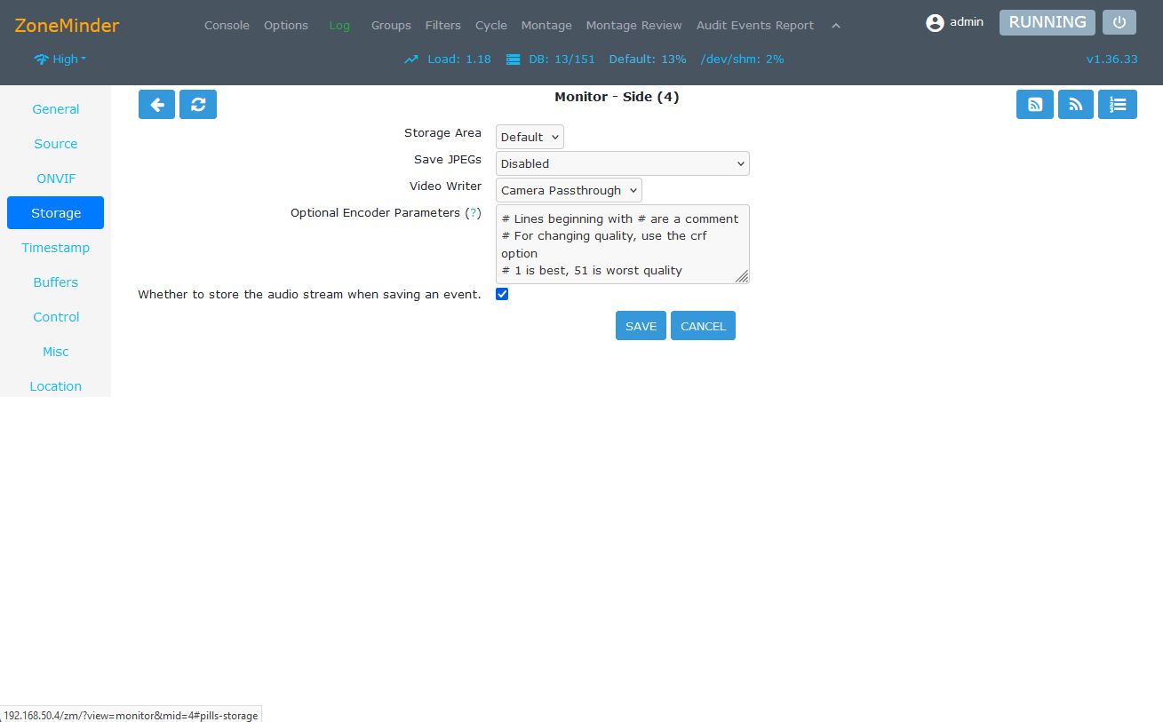

Here are screen shots of my Amcrest cam settings in Zoneminder:

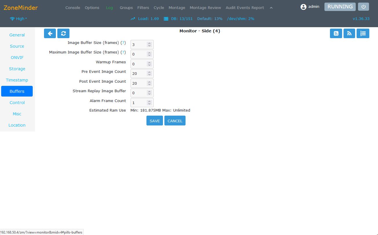

Two more:
