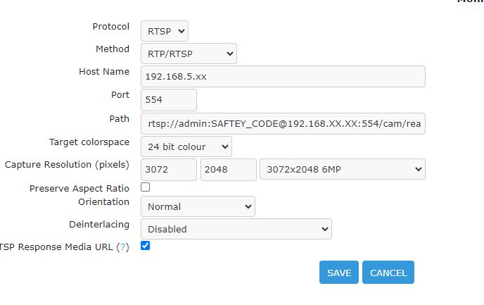

I've bought some cameras IMOU and i want to use zoneminde on a PC like a recorder
The problems is that i can`t obtain the live image.
I can`t connect to the cameras
I`ve trie a lot of configuration thaht i found on this forum and in other places and I can't get it
I've set static IP.
I've used this config with this path:
rtsp://admin:SAFTEY_CODE@192.168.XX.XX:554/cam/realmonitor?channel=1&subtype=0&unicast=true&proto=Onvif
Atached the config
Can anyone help me? What i am doing wrong?

See: https://wiki.zoneminder.com/Finding_Camera_Stream_Paths
It's easier to troubleshoot with ffprobe or ffmpeg.

What model of imou do you have?

First of all tahnks for your fast reply
I've two models, one is a Cruiser dual and the other one it's a Cell 3
I'm completly new in this world so thanks for the info.
I'am doind some test and i'll update the post
thanks

I've been doing some tests with the cruiser dual
I'cant view the image and contor it with ODM program
But i cant get it with zoneminder
The rtsp that i can view on ODM is:
rtsp://192.168.5.xx:554/cam/realmonitor?channel=2&subtype=0&unicast=true&proto=Onvif
But with zoneminder i cant
i've tried too on VLC and i can hear the sound but i can watch the video

Good Morning
I've advanced with this config and now i have the camera on ZeoneMinder
I've used the config of Dahua (wich it looks to be the manufacturer of IMOU cameras too)
https://wiki.zoneminder.com/Dahua
Config Tab Option Config Setting
General Source Type Ffmpeg
Source Source Path rtsp://admin:password@192.168.0.xxx:554/cam/realmonitor?channel=1&subtype=0&unicast=true&proto=Onvif
Remote Method UDP
Target Colorspace 32 bit colour
Capture Width (pixels) 1920
Capture Height (pixels) 1080
Preserve Aspect Ratio Unselected
Orientation Normal
Deinterlacing Disabled
