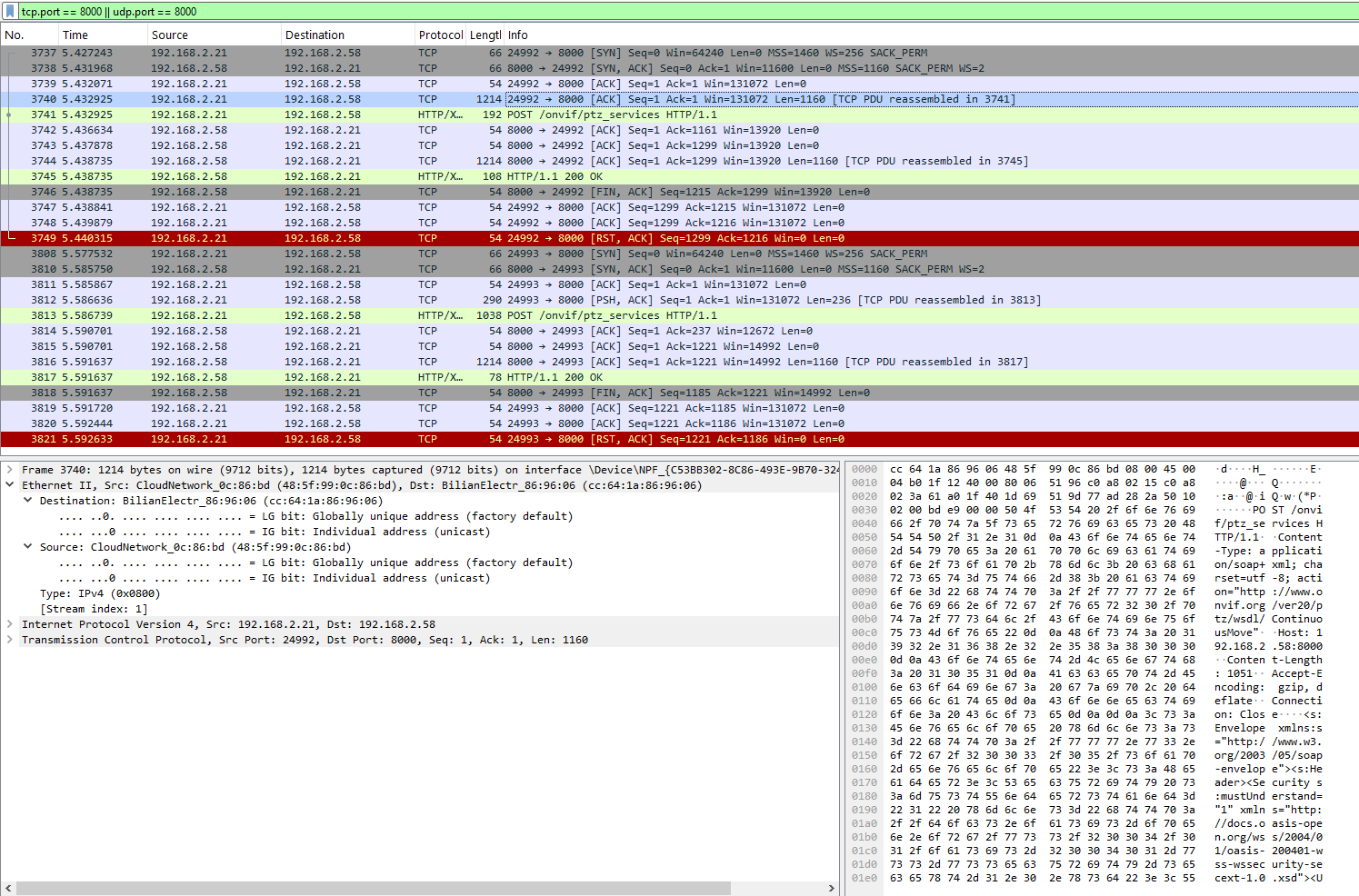

as it works with ODM I used Wireshark (WS) to get the packets what ODM sends to port 8000 if I use PTZ
First this is sent:
<s:Envelope xmlns:s="http://www.w3.org/2003/05/soap-envelope ... ><Security s:mustUnderstand="1" xmlns="http://docs.oasis-open.org/wss/2004/01/ ... ><Password Type="http://docs.oasis-open.org/wss/2004/01/ ... ord><Nonce EncodingType="http://docs.oasis-open.org/wss/2004/01/ ... e><Created xmlns="http://docs.oasis-open.org/wss/2004/01/ ... er><s:Body xmlns:xsi="http://www.w3.org/2001/XMLSchema-instance" xmlns:xsd="http://www.w3.org/2001/XMLSchema"><ContinuousMove xmlns="http://www.onvif.org/ver20/ptz/wsdl"><P ... LE_000</Pr
But how can help me this in ZM? AT least I can see: /onvif/device_service and /onvif/ptz_service
A usage in ZM has no effect.
