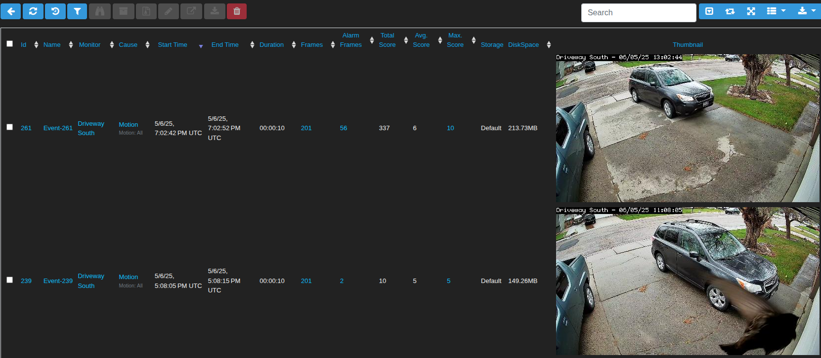

Just had to do a clean install as I'd been negligent in upgrading my base OS and it did bad things to itself
ZM V.1.36.35 on brandie new install of Fedora 42 Server - nothing else installed or running on that box
Local time zone was set on install, all events are displayed with UTC time stamps, while the in image 'timestamp' is local.
Just did set the timezone in php.ini and restarted apache and zoneminder.
Very next event a few minutes after restart showed as UTC in the event display with no change to the in image timestamp.
Looking for more suggestions on getting local time in the event window instead of UTC.
Note OS is set to local timezone as well
Screenshot From 2025-05-06 13-09-23.png (923.02 KiB) Viewed 2754 times

Zotter
Posts: 7
Joined: Wed Oct 31, 2018 8:06 pm
Re: How to show local time (instead of UTC) in events-list?
Post by Zotter »
Had a power outage - again, my fault for not using a large enough UPS - but now, all the event times are showing MDT instead of UTC. So, seems the whole thing DOES need a re-boot to implement what I'd read to do, and then did, to correct things. Not just restart apache and zoneminder, but reboot the whole box. It's good now.
