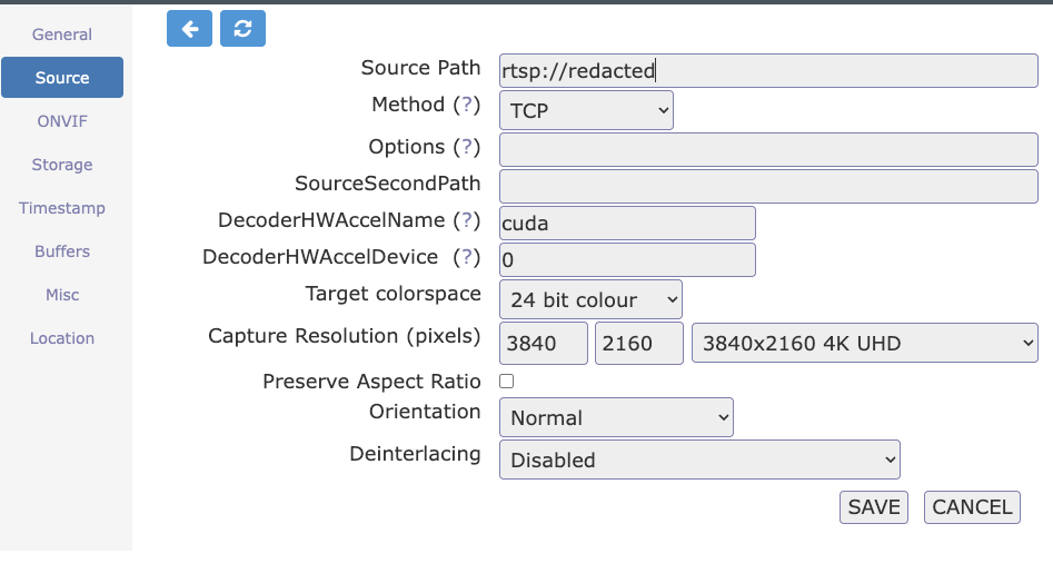

Under Source, I set:
DecoderHWAccelName: cuda
DecoderHWAccelDevice: 0

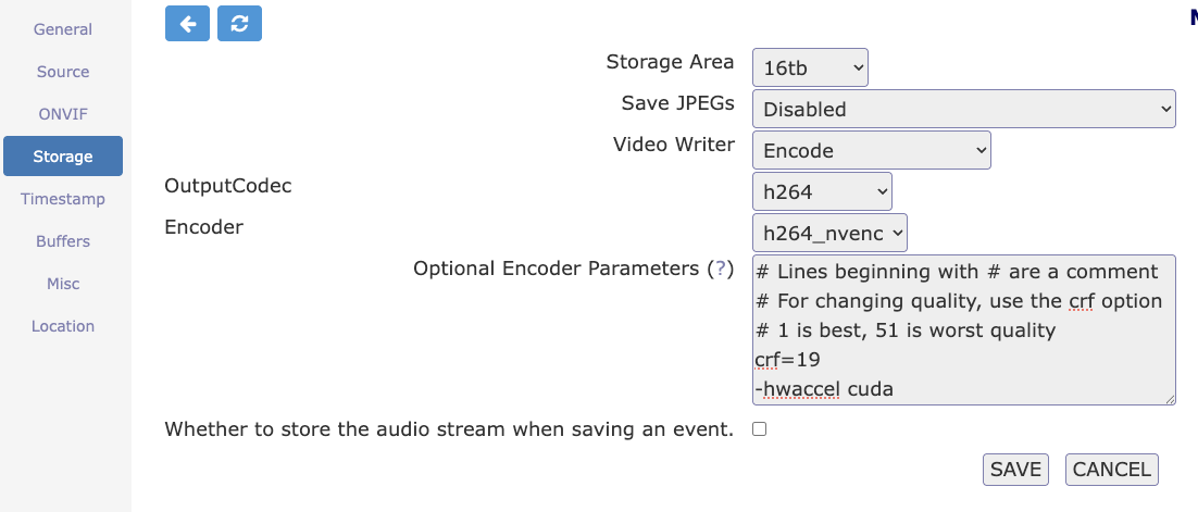

Under Storage, I set:
Save JPEGs: Disabled
Video Writer: Encode
OutputCodec: h264
Encoder: h264_nvenc
Optional Encoder Parameters: crf=28 -hwaccel cuda

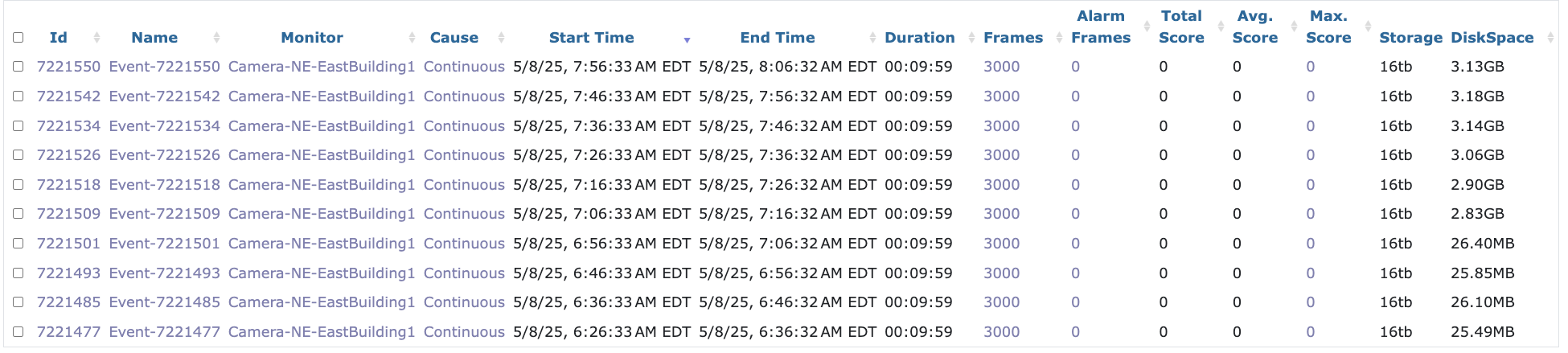

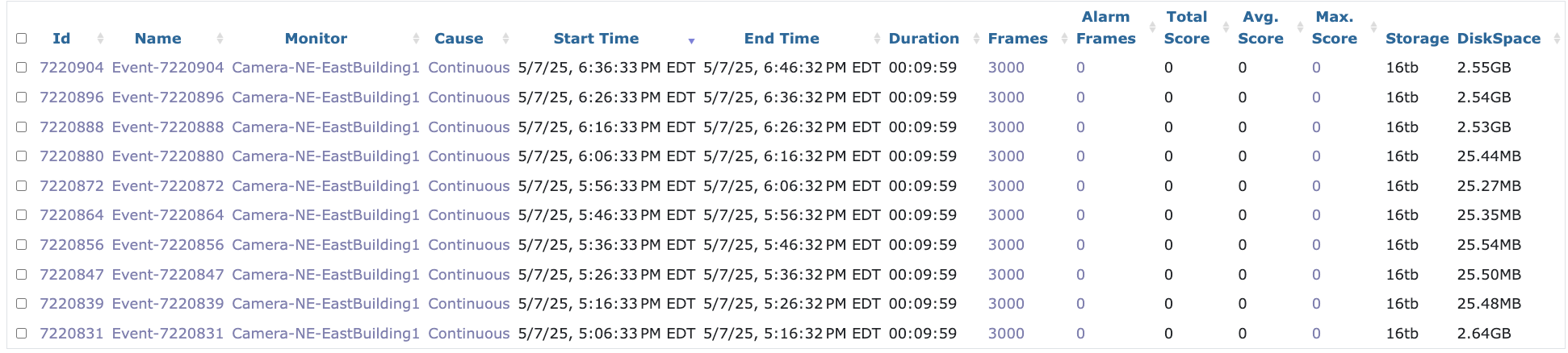

I let it run for a while and was getting 25 MB video files. That was great. Then I came back later and saw that some of the events were taking 1 or 2 or 3 GB. Looking at the filesystem, I saw 3000 JPEGs in the event folder. Looking through the events for multiple monitors, I see some events that are 25 MB videos and some that are 3 GB of JPEGs. I see no pattern.
Did I set something wrong? What can I do to change this behavior? I'd appreciate any help.

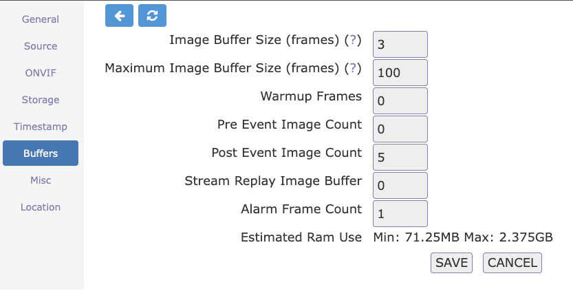

If JPEG encoding is disabled, you should not be seeing JPEGs. Please post screenshots of the monitor settings.

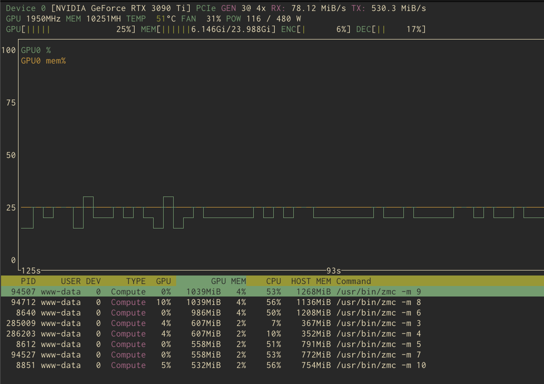

Enable debug logging on zmc for that monitor. Make sure that the GPU is actually running in ZM. What does it output?

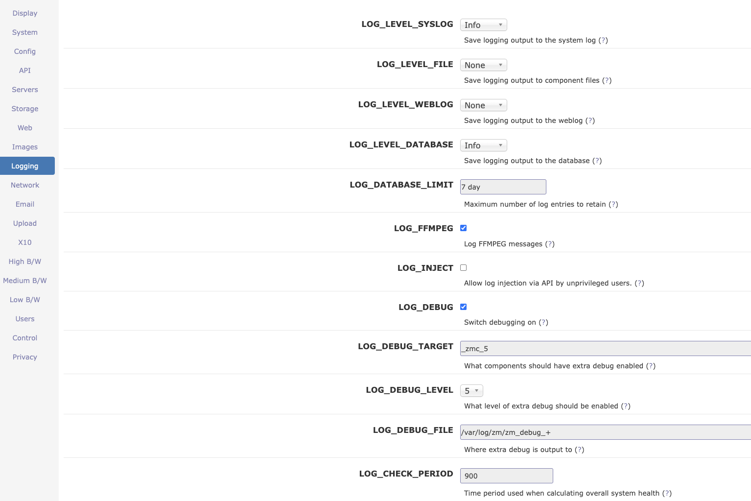

Hmm. I wasn't able to get logging to work. ls /var/log/zm shows nothing. If 5 is the ID of the monitor, should I use "_zmc_5" for the debug target?
However, nvtop shows the GPU is being used, if that is the info you're looking for.

I've added a screenshot with the proper syntax for zmc: https://wiki.zoneminder.com/Filters#Log ... r_in_Debug
Though you may want to keep LOG_FFMPEG enabled, which you have in your screenshot. I'm not sure where the FFMPEG logs output to.
The debug target should be: _zmc_m### Where the number is the ID of the camera.. Make sure it is the 5th by reviewing the console. The ID will be listed in the first column on the grid in ZM 1.36 (or in top/htop/nvtop as you are seeing above).
/var/log/zm will have nothing unless you enable component / file logging or you specify debug logging to a target. You don't need to enable all file logging, only the monitor that we are concerned with here, which is #5. See the example above as a reference.

If I'm understanding you, I just needed to change "_zmc_5" to "_zmc_m5". I did that, and I still see nothing in /var/log/zm, or /tmp/zm.
I'm using Debian; is there an issue with systemd logging or something? /var/log/syslog has lots of zm warnings of "Decompression must happen before presentation." as I said before.
And to clarify, the problem is happening with all cameras, not just #5.
