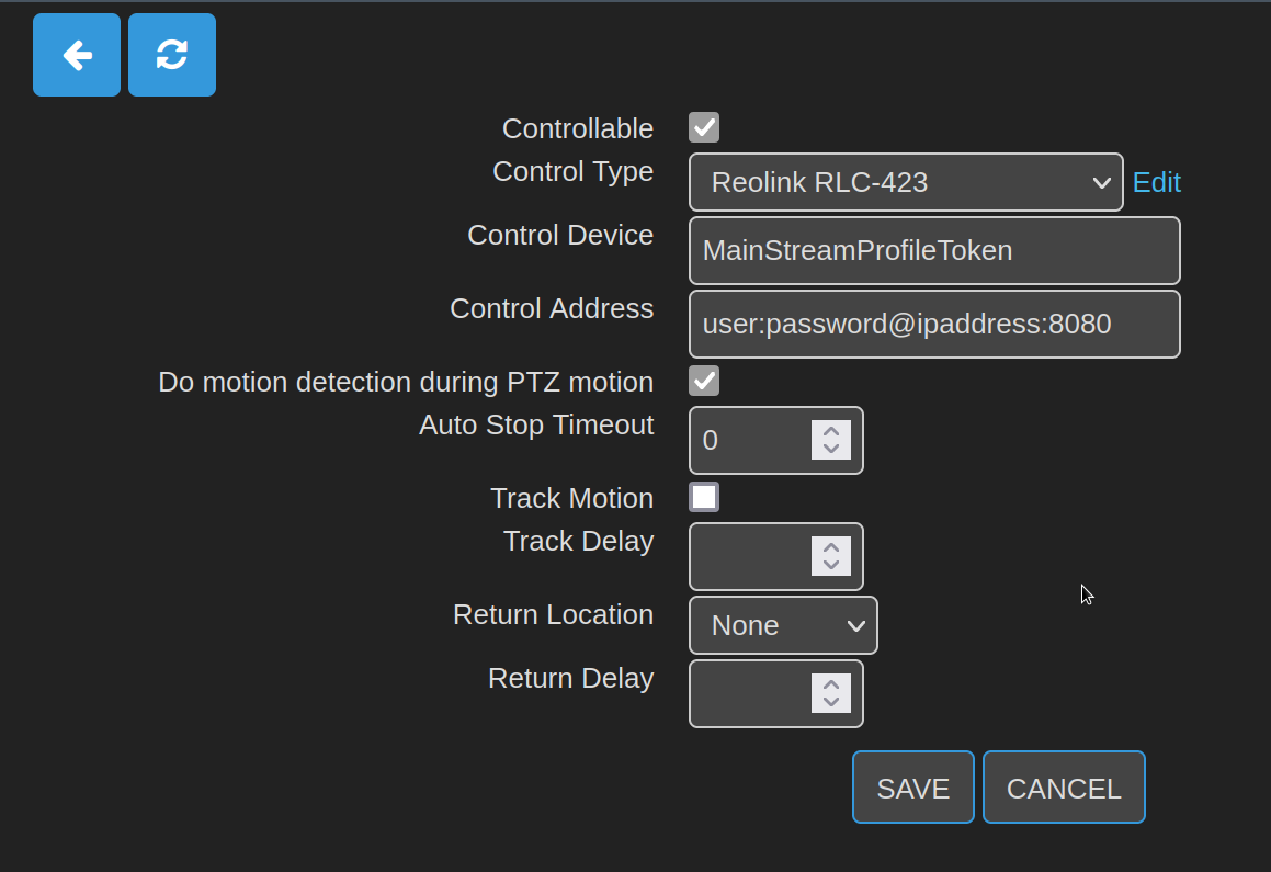

I've had partial success getting the iegeek i20 camera working on ZM
It should work under the ONVIF but the logs give Error 400 bad command
But if you add the camera as a Reolink RLC-423
with the control address as
user:password@ipaddress:8080
as per the below snip.
using an ONVIF client on an Android phone you can have full control of the camera so the camera is capable of ONVIF so there is an issue with the ZM ONVIF config.
Screenshot at 2022-06-05 10-52-12.png (81.29 KiB) Viewed 7784 times

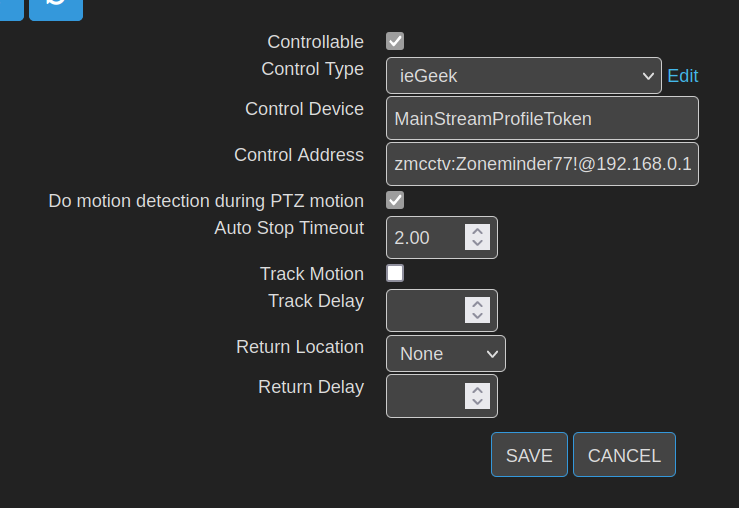

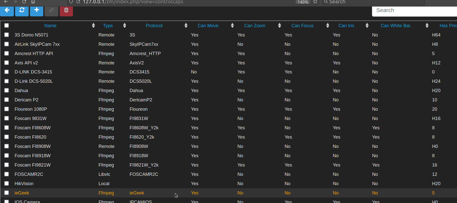

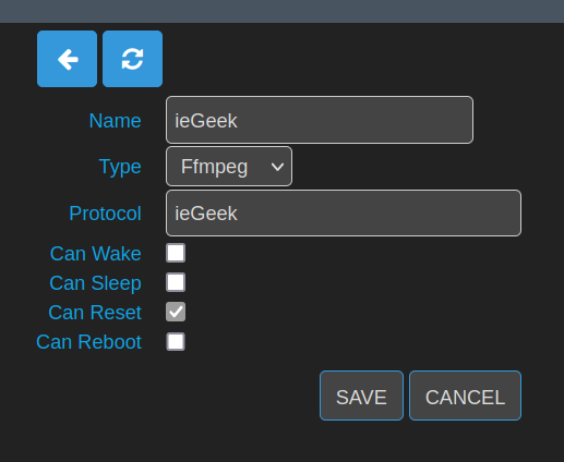

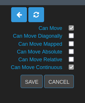

Ive managed to fix the continuous movement issue with the Reolink PTZ config.
Place the below code into the /usr/share/perl5/ZoneMinder/Control folder or where ever your distro keeps the config files and name the file as ieGeek.pm
Then you need to make your own profile inside ZM and reference this ieGeek file, if you just look at the other configs you will start to see how it is formatted..
I'll add this to Github when I get time.

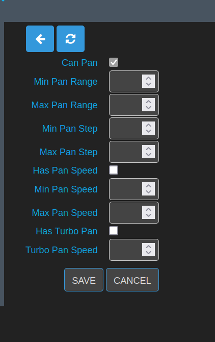

[quote=clipo post_id=126801 time=1654808824 user_id=13492]

The ieGeek wont appear by its self the above scrip is the background control "protocol" file.
Once you have the control "protocol" file you now need to manually make the "Control Type" in the database by pressing the "Edit" button as shown in the first screen shot in my previous post.
You will then be give the menu in the second screen shot in my previous post, you can then either edit one of the existing profiles or make a new one by pressing the "+" button and then enter the "Name" of your choice but enter the "Protocol" name as ieGeek as per the file name of the "protocol" file you made at the start and choose the check boxes required for the control types similar to those shown in this post.
This will make an entry in the database and give this as an option for you to select under the Control tab.

Update for ZM 1.37.66
Screenshot at 2025-05-25 14-35-06.png (58.94 KiB) Viewed 714 times
