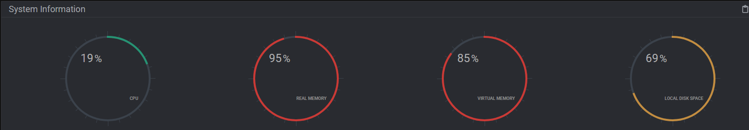

And it takes 6 minutes after restart to go back to 98% used memory...

Lamer wrote: Sun Oct 23, 2022 1:10 pm
mendozaLt wrote: Mon Oct 03, 2022 2:52 pm Been waiting for a solution for long time :( ... but for now i just had to stop zoneminder, as i cant use it normally...
Have you tried to set "Maximum Image Buffer Size (frames)" to some value instead of 0? Actually the meaning and effect of this parameter is not quite clear to me, but setting this to 1000 (for exampe) may solve the problem. Anyway in "Buffers" menu you'll get the definite max "Estimated Ram Use" instead of "Unlimited".
I tried, this is after setting it to 500 (remember, server has 56 Gb in total, and ZoneMinder takes 43 of it...):

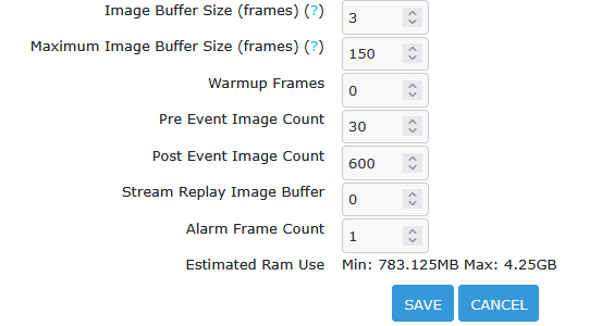

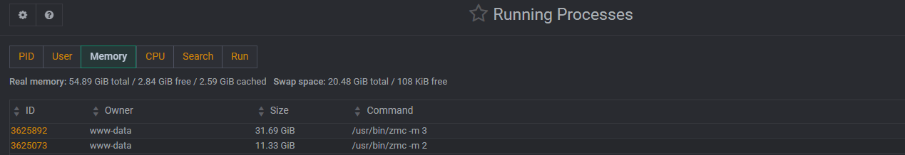

Can anyone explain how it is possible? Why do I have duplicated monitors 69 using 8Gb of memory in S sleep state? It's just simple monitor with motion detection 12fps 4k. Recently I have low memory problems, sometimes, maybe after update, I'm not sure. Can't see any noticeable errors I will increase log.
Or maybe I should try 37 version...
Or it's just normal?, I added 16gb, who knows, maybe it will help. So memory hungry)
Screenshot 2025-05-29 012456.jpg (390.15 KiB) Viewed 306 times
