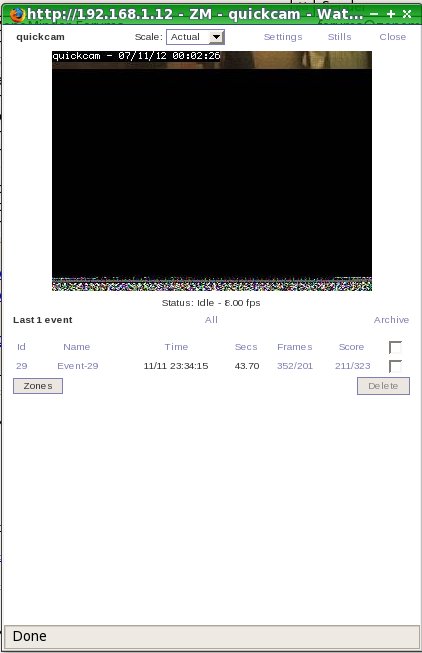

I have one of those cameras (Logitech Quickcam Express), most of the time I view the camera it seems corrupted (see image).
This doesn't happen all of the time, but it does most times I view the cam.
Have you come across this before and do you know how to fix it?
